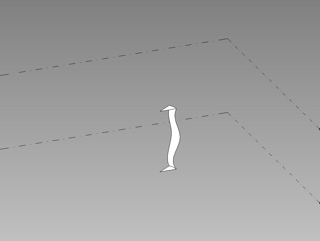

I been created that element using the revolve method and then change the end angle from 360 to 36, how do I make it in to a solid element?

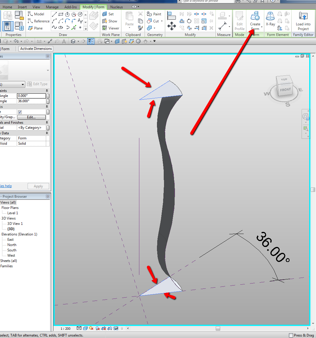

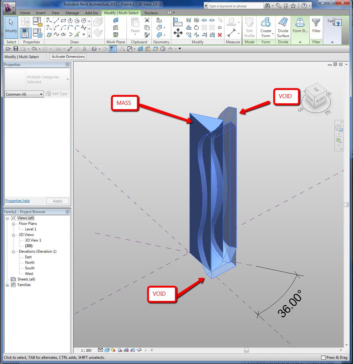

Now select those 4 lines and click on "Create form" like you can see in my irst image, then you will need to create a couple of Voids to cut the exceeding form like you can in the third image.
This is the "Hard Way" to solve the problem, now look at the next post to see the "Easy way".

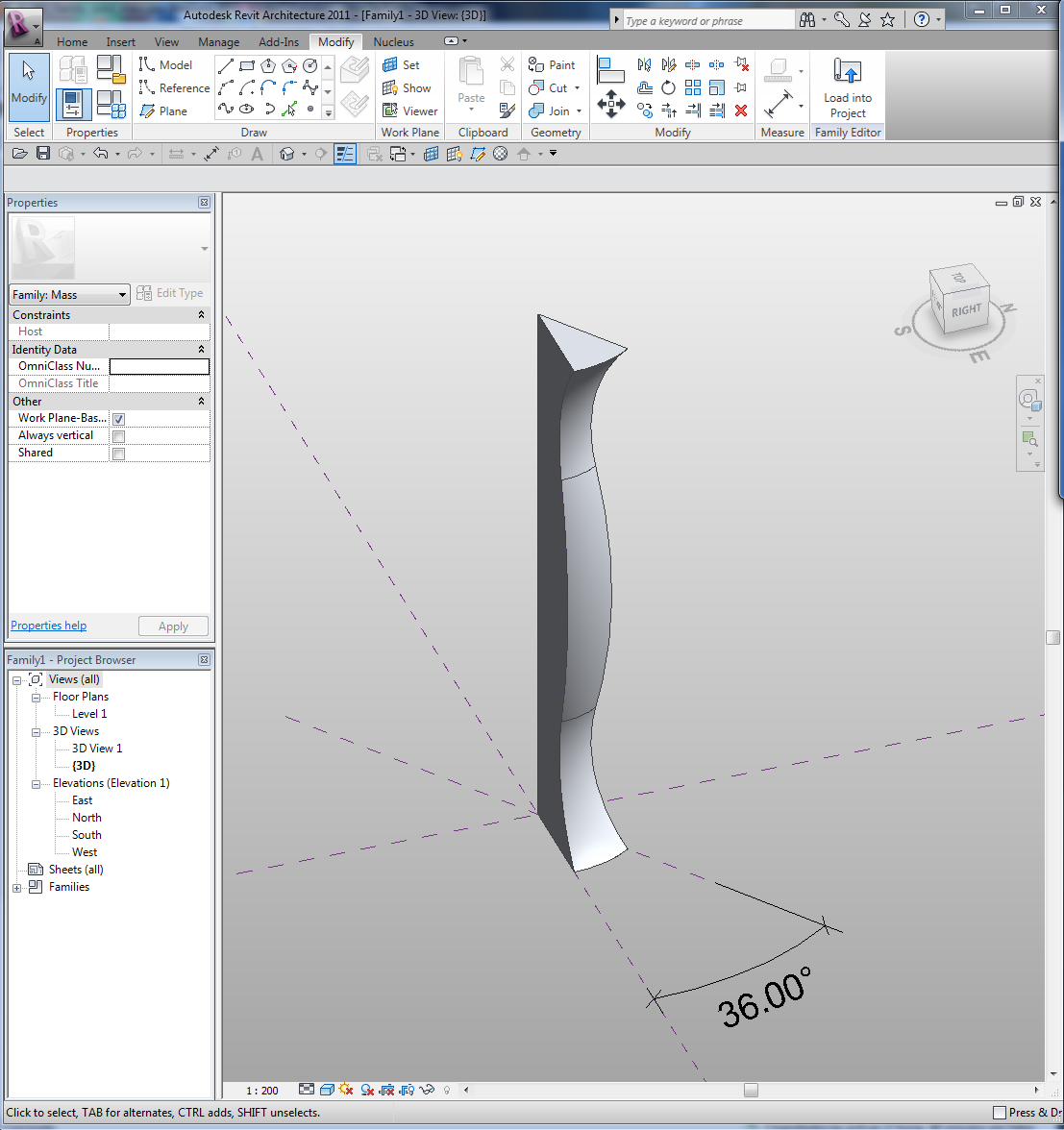

And this is the "Easy way": http://screencast.com/t/X1QVY5ktN0sP
