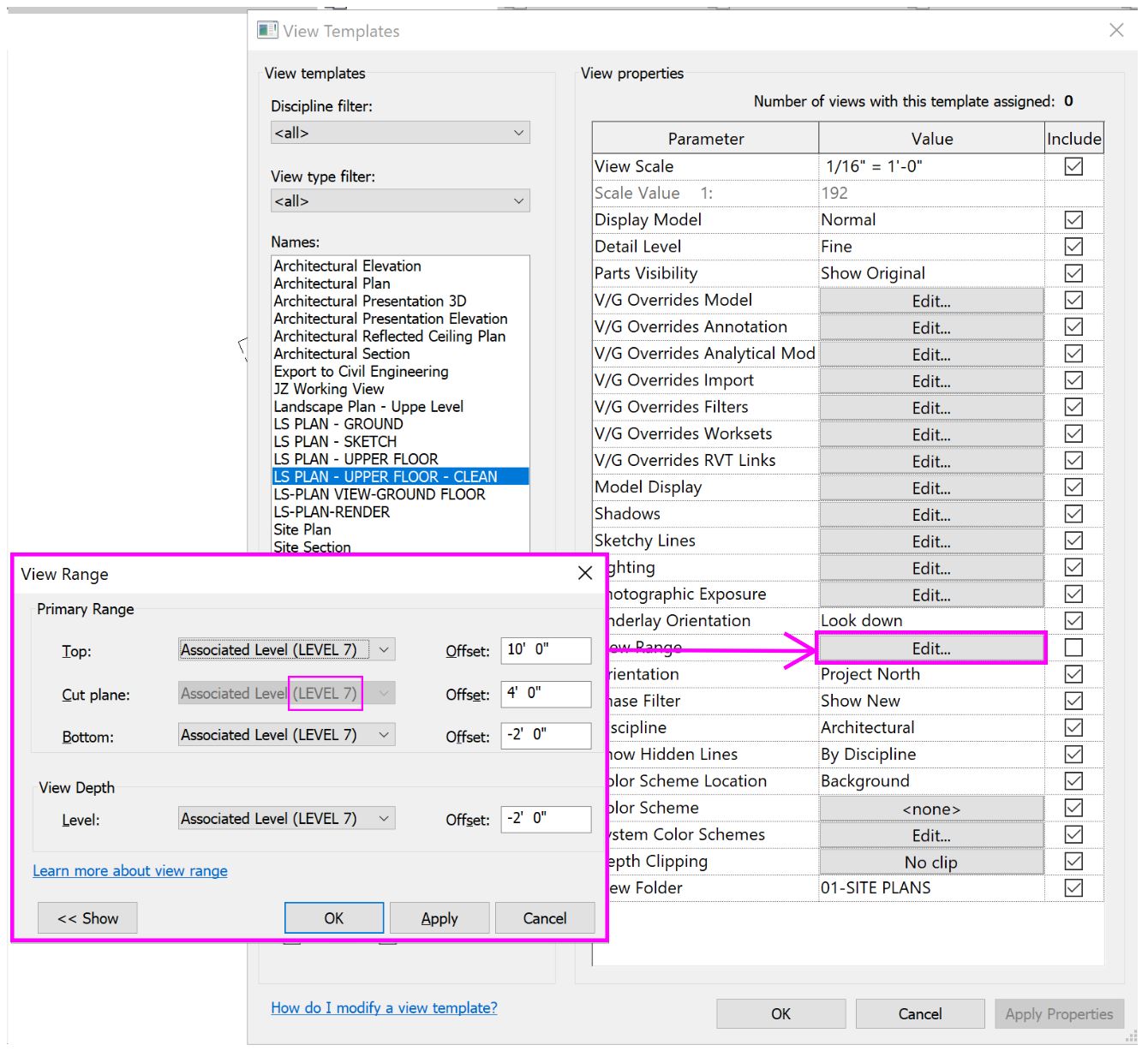

I did this exact thing today by mistake!
If you apply a view template to your view that was created on a different level and that template's view range properties box is checked then it WILL override the associated level in your views! See attached jpeg "A".
The good news is that it's easy to fix: make a new view template and unchecks ALL the properties except for "view range". Next, set your view range to the generic "associated view" in the drop-down menu (see attached jpeg "B"). Applying that view template to your screwed up views will reset your associated level without changing any of your other settings.
Just be sure to delete this fixer-upper view template after you're done, and UNCHECK the view range category in the original view template.

Realizing I am replying to an old thread here, but I'll give it shot since it relates to what I am trying to do...
A colleague has somehow done something similar to what is shown in nlevinson's post - i.e. created a view template that has a view range associated to a specific associated level (in this case Level 7), rather than just a generic "associated level".  This template seems to have the unique ability of being able to re-associate another view to Level 7 when applied as a template.  I'm trying to re-create the effect with a different level, but I cannot figure out how to do it.  Any ideas?  I.e. how to create a view template with a view range that defines a specific level as the associated level.
