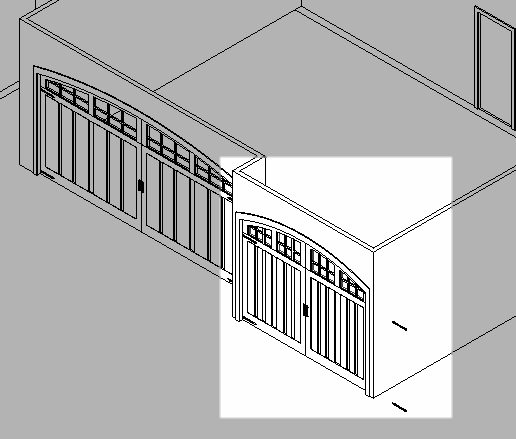

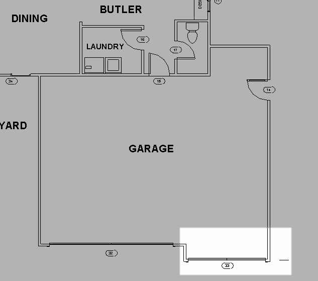

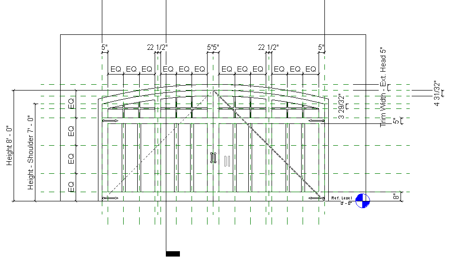

I'm a little rusty on families but reading up and trying to learn. I have this garage door I downloaded from revitcity that is parametric and works fine inserted as a larger size but when I try to make it a 10' wide door, the hinges on the right are waaay outside the door. Can someone advise me on how to correct this. (see attachments)

Edit the family and costrain the hinges to the right door opening or frame or better off a ref plane on the right side of the opening.
