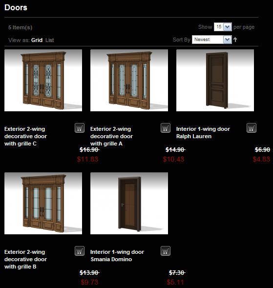

Here is small bunch of doors http://revitbay.com/categories/doors.html

I like the look of this site.
 Another REVIT content seller joins the market ! Good luck.
This site looks promising but needs more content (only 5 doors and 3 windows).
I am still not convinced that in the long run, selling REVIT families will be prosperous. Eventually the manufacturers will simply provide there products for free in RFA format. Would they not?
Also, you have to wonder about 'legalities' when you produce a family and 'sell' it for profit as a product of a specific manufacturer? Does the manufaturer have to santion the use of their name when you sell a family with the understanding that it is their product? I'd say yes if you use their name.
I am interested mccadman, on a business perspective. Do you require a legal 'ok' from all the manufacturers listed on the left hand side of your site before you can 'sell' an item represented as their product in digital format?
You have Sony listed their. You can't just pick up the phone and call Sony ! Are they even aware?
You may need a little disclaimer or add the letters (ish) to all the manufacturers.
Anyone else have thoughts ?
