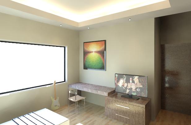

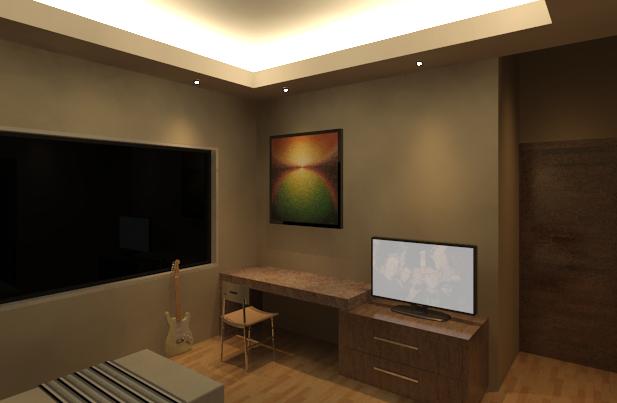

i have i question, i am trying to render a tv with an image. when i do it on artificial interior it just shows like a white light and with the sun hitting it looks great, i have tried different settings on luminece on the decal options with no good results
can somebody help me? i just want to make look like a tv rather than a fram with a picture  or how do you recommend me to work this around?

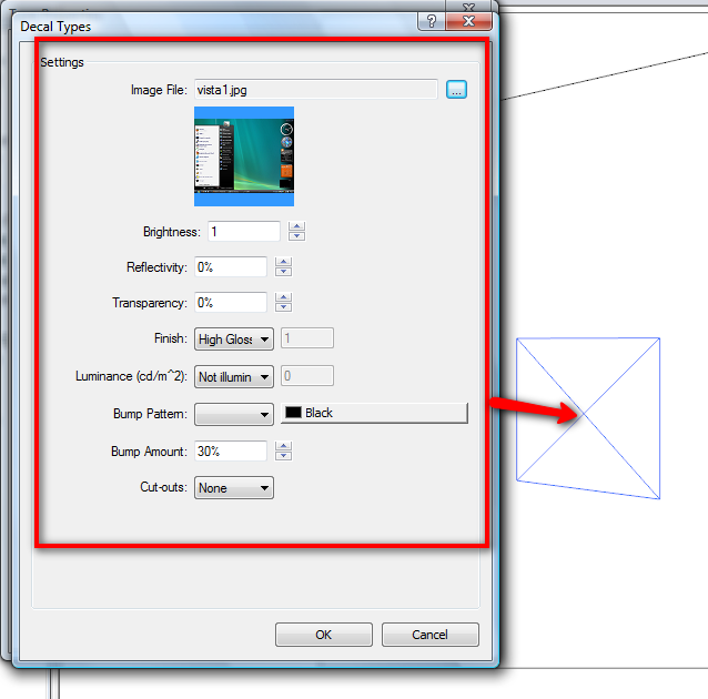

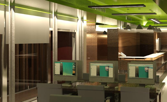

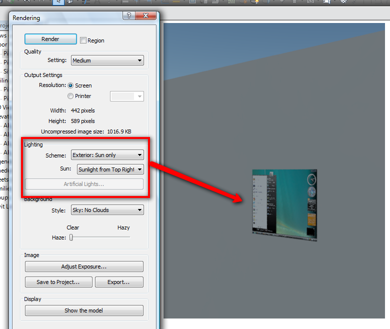

It work with a Decal too, you must "play" with the properties of the decal....Brigtness, transparency and so one, look my image attached...

Looks great Ty,
I must say the whole image looks great whit all those light fx's.

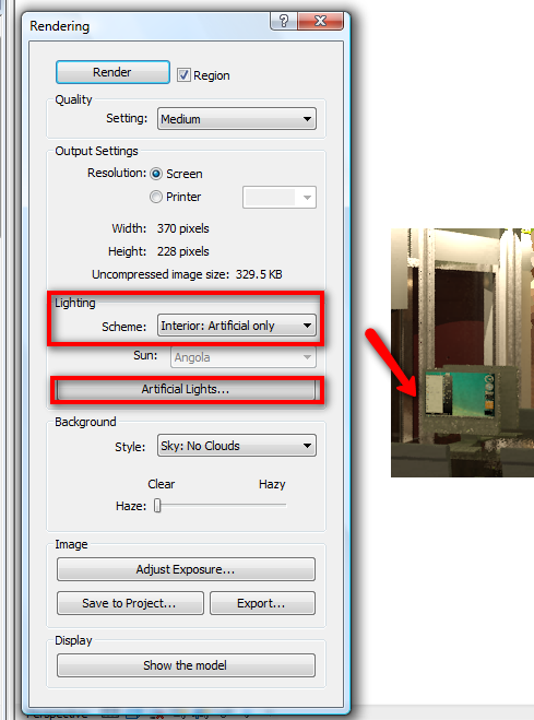

i have tried like crazy and i have the same result. cant do it, could you show me an example with interior artificial only and one with sun only? what properties you choose?

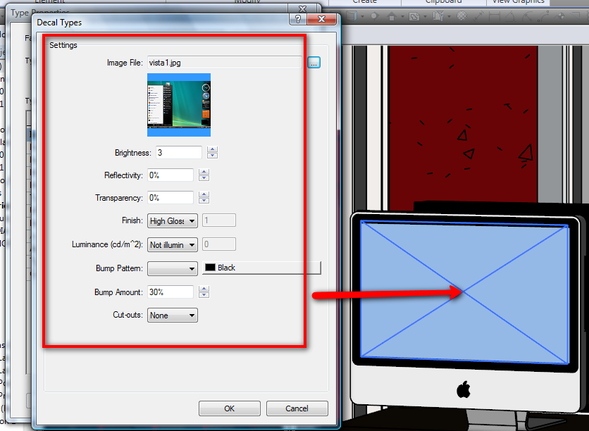

Here you have....

my mistake was i used the option of lcd screen on luminance
i appreciate your help
