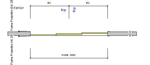

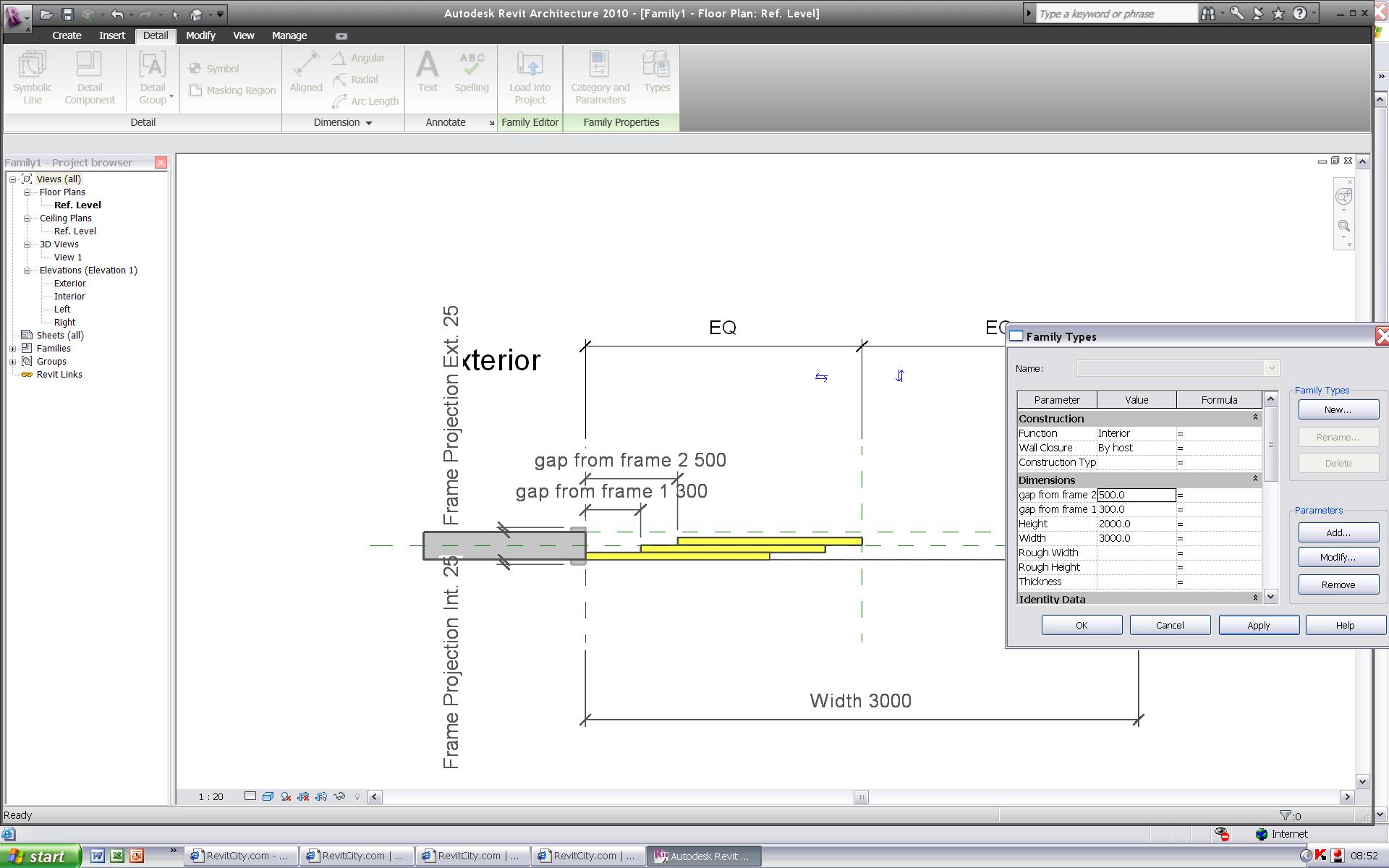

with your door the great thing about revit is the fact that it''s parametric, so you can make the door you want
If you choose new > family > metric dooryou can a blank template to crete yourself a door
If you need help creting the rule to create your family post a link on here with your family file or images and we'll be happy to help but as a rough starter follow this:
create a metric door family and make press 'types' on your ribbon and set the height and width to what you want.
draw 3 door panels using solid extrusion and set them within your door frame on a slight offset of each other (as shwon in image)
with them all a dimension and label as parameter and name them something like 'panel gap from frame 1' (as imaged)then you can save it and use it in your model
you can make these rules as complex as you like, but this is a simple way to start you off, hope that helps

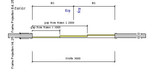

Thanks to you guys I finally decided to push myself to learn how to do it myself and I'm so glad I did. Here is what I came up with. It is a very simple adjustable sliding door. I am just having one problem.
 In plan view I would like the door to be about slightly opened as shown in the attached PDF. I have taken the first couple of steps to do like hiding the 3d panel doors from the plan/rcp views and I have created some model lines in the door (cut) layer. This can be seen on the Ref view in the RFA file.
 The next step really is to get the size of the model lines to adjust in proportion to the width of the opening. So when the door width is increased or decreased the panels will adjust proportionally. This is something I do not know how to do.

I see that you have the symbolic door panels dimensioned and locked. Instead of locking the dimensions, make a new parameter (Panel Width, or something like that) and in Types, make the Panel Width formula "Width / 4" (no quotes). You will also need to lock down one end of the panel or the other, but there are a few different ways to do that. You could even tie them to a parameter so you can control how far the panels are opened.
One other thing I saw is that your dimension parameters are all instance parameters. Is there any reason that you are not using type instead of instance?
