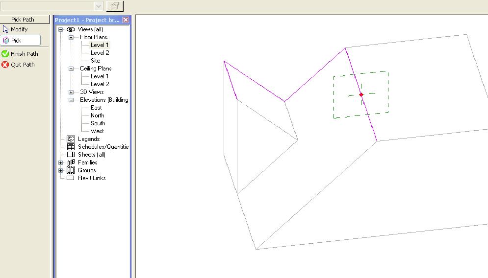

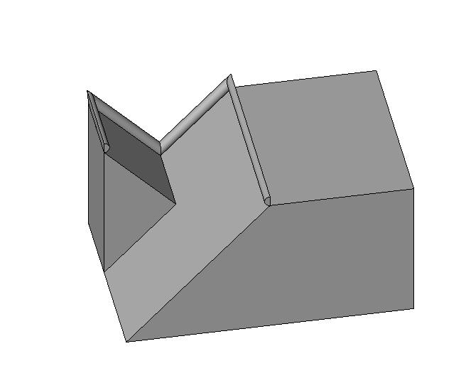

Yes...you can have a 3D path...there is a command "Pick Path" in the sketch mode of Solid Sweep. Depends upon your shape you can pick the path in 3D view. Check the attachments.

Pavan, I've tried it in Revit, but my model was of a free-form-nature, and I resorted to modeling it in Sketchup and importing it into Revit. After spending 2 days trying to get it done in Revit, Sketchup sorted me out in 30 mins.
