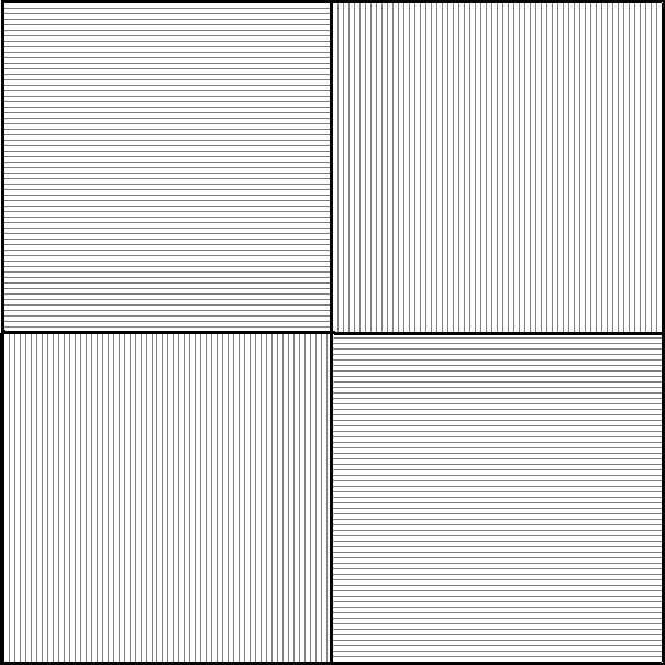

I am working on an exterior residential rendering and the parking area (concrete) is just too flat looking.  In actual construction it will have 10'x10' control joints and be broomed in opposite directions in each square.  For my parking area, I have a split surface with concrete material.  Is there any way to model the joints with the surface? or do I have to do all seperate floor slabs?  Any direction would be appreciated.  Thanks.

You can easily create a bump map for it by just drawing some lines in a Revit drafting view and doing a screenshot.  Crop it in Paint and apply it as a bump map to your concrete

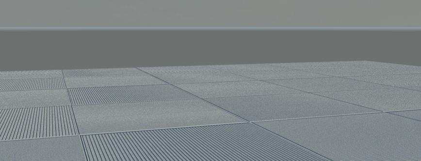

You could achieve a more subtle effect by decreasing the line spacing and making the grey lines lighter.  The attached image shows the result of using the image that I posted above (with the joint spacing at 3m, approx 10 feet).

That looks amazing.  Did you apply the image file to the "weathering" under custom from the out of the box cast-in-place concrete or did you do something else?  Thanks

Under Finish, choose custom and insert the image.  Adjust the size and bump amount to suit.  I used 1 for the bump value.

Sorry,  I didn't specify, but this is for a topography surface since the slab will follow the grade level and not be an even slope in one direction.  Tim's suggestion seems to be working great.
