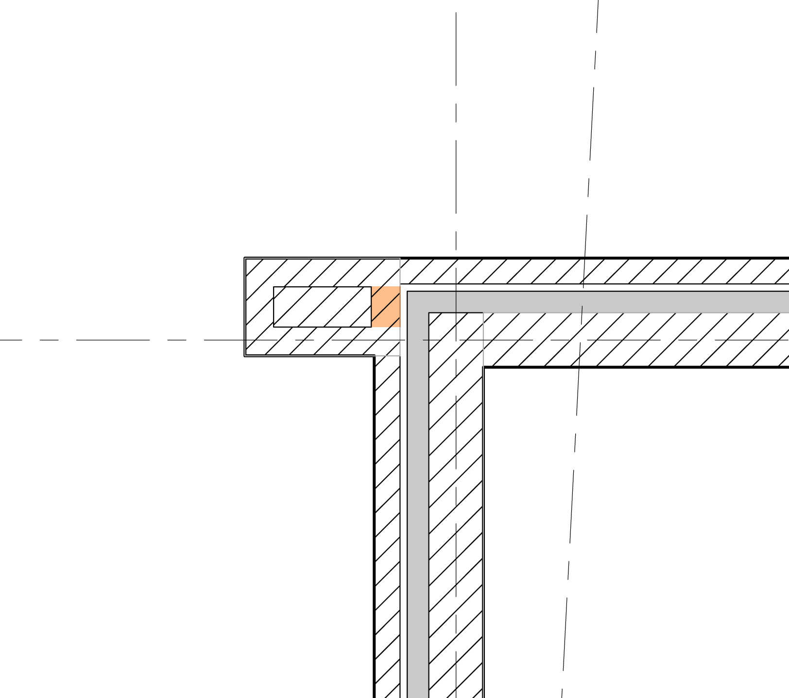

Hi I am trying to create a nib wall, with brick on blocks. i need it to wrap at one end and not at the other. But I can only seem to get it to wrap at both end. My setting is: finish 1 brick(wrap), core: block, finish 2 brick(no wrap). At insert: do not wrap, at ends: exterior. Is there anything I can do about this? Thanks (revit 2010)

Try clicking on the yellow dot at the end that you dont want to wrap, and hit disallow join. They may have the look your looking for.

Sorry maybe I wasn't too clear with what i want. I've tried joining/disjoining of all sorts. Please see attached jpg. I want my block wall to extend to the part i have coloured orange. I know I can mask it with detail fill, but if there is a way to make the model correctly it would be great. Any other suggestions? (thanx allen)

Do you mean like this?

Or this?

hi Tim, the first one is exactly what i need. So how do i get there? susan

It consists of two wall types, shown in the two attached images. Note the position of the layers in relation to the core boundaries. I pulled them together, as shown in the image that I posted earlier (if the layers don't clean up properly at first, join the wall below the corner and move it up to the corner).

Missed the other image - here it is.
