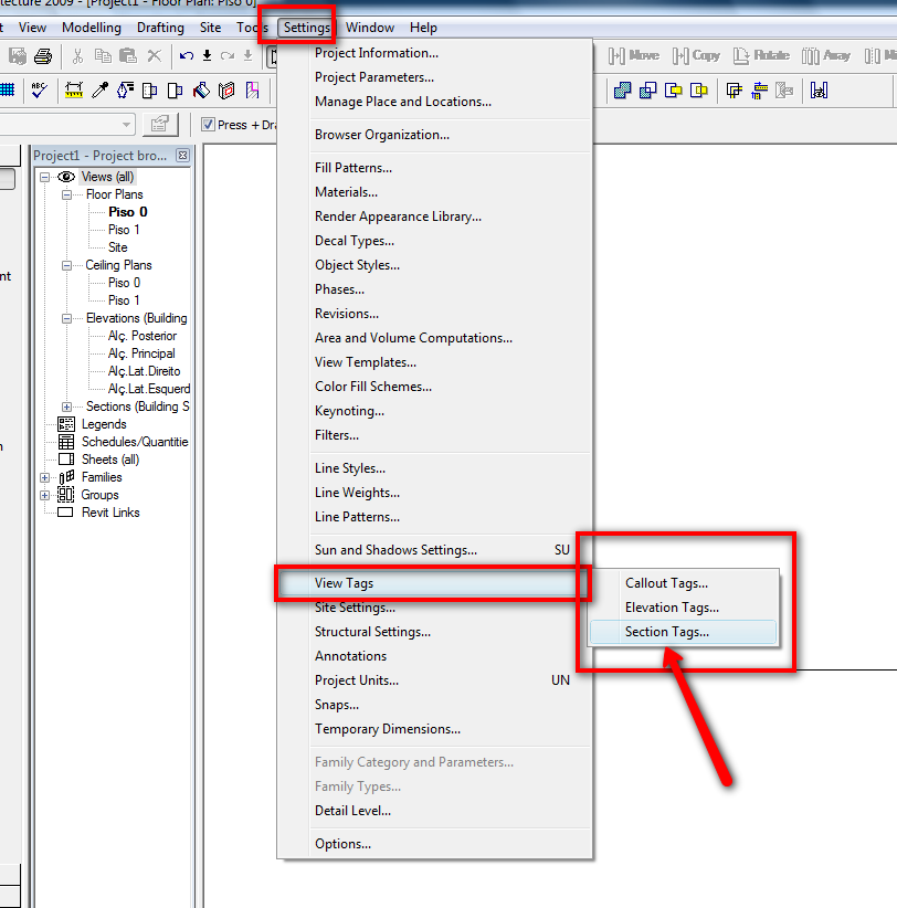

In object styles I can modify callout heads, changing line wt. and color, but there is no way to change section heads? can someone please point me in the right direction? Thank you for any help.

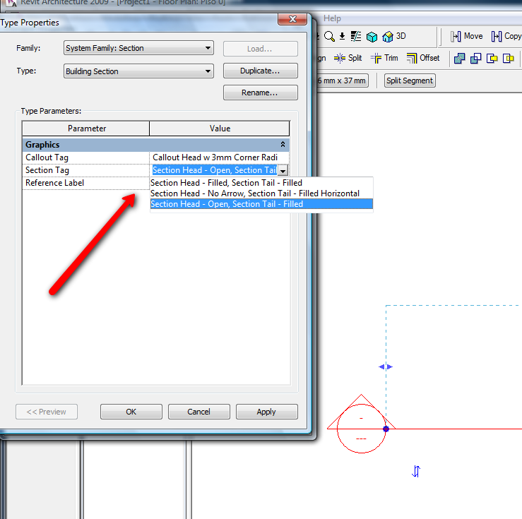

You can create a family like you want, load into the project and in the Settings>View tags>section tags use the new family you want..
