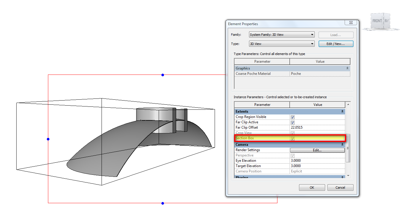

Hey all,
 I know you can create 1 point perspectives in revit but i'm looking to try a 2 point perspective, preferably
a section perspective.  If there's anyway to do this it would be greatly appreciated.

Turn on the section box in the perspective view.(in Element properties).

I'm still looking for ways to make two-point perspective sections in 2017 and still haven't figure it out. the solution by erland73 is an one point perspective because the view in that screenshot is a funstion of the camera not the section box, that solution is an approximation (shortcut/cheating) but thank you for the work around. Does any one know how? Any help is welcome.

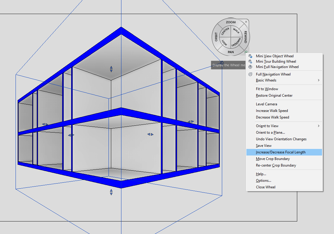

camera views in revit by default are two point perspective... (actually for one point perspective view you need to align camera view with section box and use the same eye/target elevation)
Maybe you are looking for a simmetrical two points perspective? but that depends where you put your camera view.
Also you can increase focal length...
