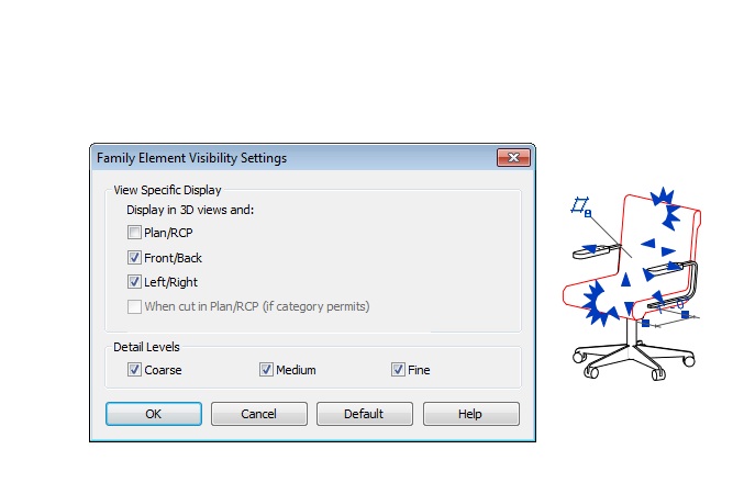

VG, is the best place to control categories... but if there's only one type of chair which you really want to see in detail, for example, but not the other furniture, it might even be worth going to the family and changing how it displays at different detail levels and types of views...
