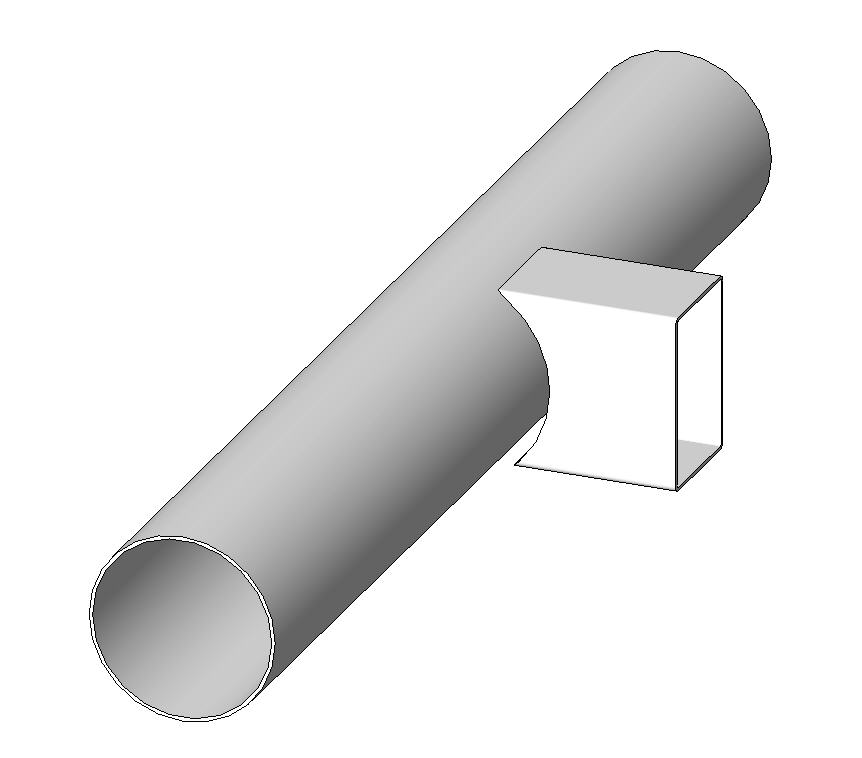

The sketch I attached is made with HSS beams, with a 1" coping distance.  This is how I want my in-place family to look, but with zero coping distance.  But I can't get it in one family.  It just seems to be I should be able to build-up a complex shape with several extrusions/voids, and be able to define how it fits together.

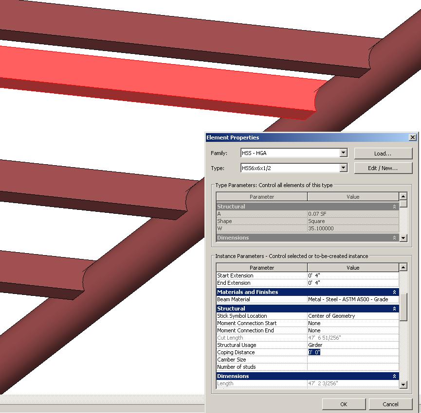

You've got the right idea, you just need to adjust the extensions and coping distance.  In the screenshot I've posted, i used a 4" extension with a 0" cope.  See screenshot.
