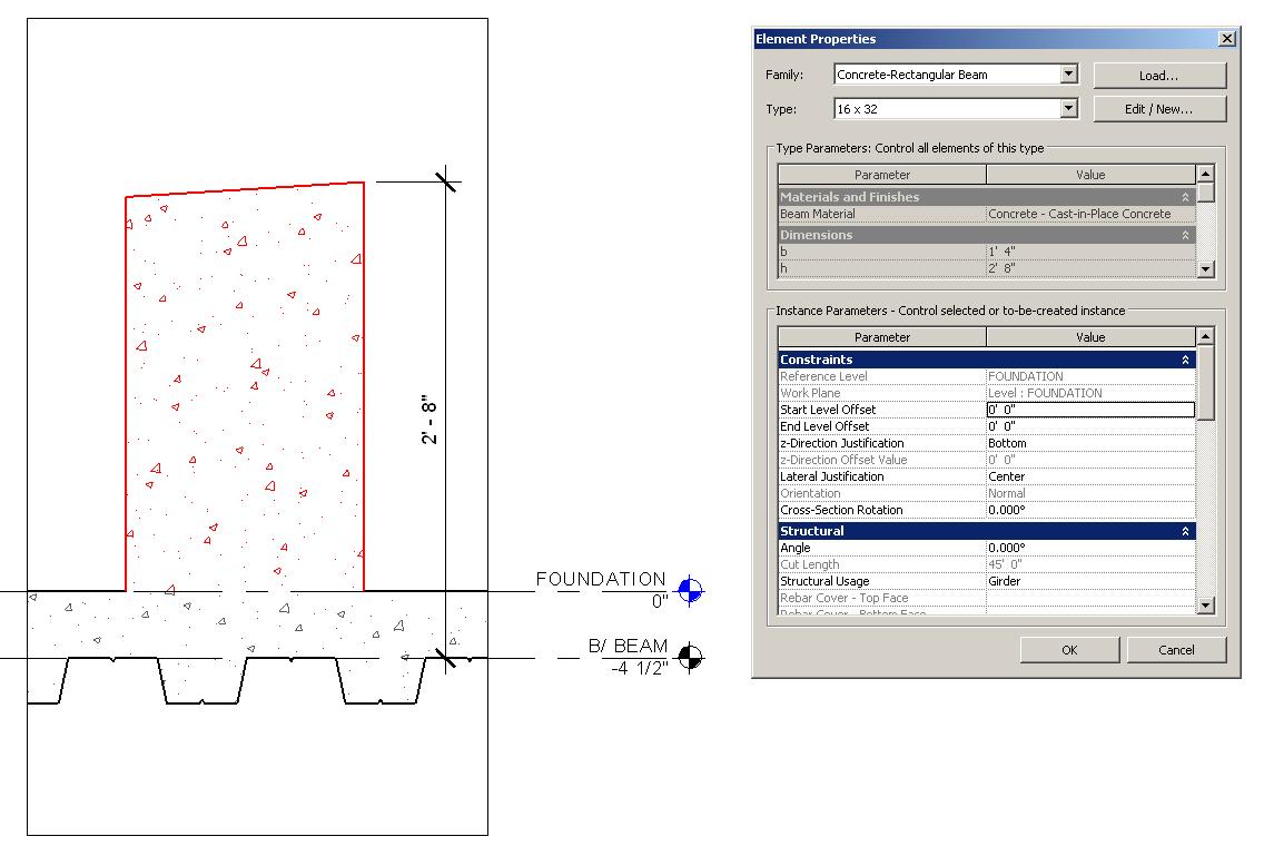

Is this what you are trying to achieve?
See attached image.
Wed, Nov 4, 2009 at 11:59:07 AM | Upturned Beams in RST 2010
krunung
Joined: Thu, Oct 29, 2009
32 Posts
Yeah it seems like it. I obviously don't know which parameters you have in that family in order to create or modify that beam. I was hoping to be able to adjust the width, height, and top slope. The main thing that was frustrating me was the fact that everytime I used 3D snap to place the beam (or even in plan view), it always inserted in the -Z direction, as though the placement axis was along the top of the beam, rather than along the bottom of the beam. Not sure if that makes sense. Either way, that seems like it coincides with what was my ultimate goal. How did you manage that?

I used the out-of-the-box concrete beam family and modified it.  Not sure what problems you are having with the family you created, or the reason you are having these problems.  I'd like to help you with that, but I don't have 2010.
I've attached my family to this e-mail.  Let me know if you don't understand it.  I've also added a control which will allow you to flip the beam to make sure the top of the beam slopes in the correct direction.
Set the z-direction justification to 'bottom'.  See previous screenshot I've posted.
Let me know if you have further troubles.

This is what I found that I had to do when I created the faulty beam. It always located itself below the slab. I found the Z-direction Justification pulldown at that point and that at least got it to the correct side of the slab. Is there anyway to save that setting that you know of so that when I pull this family in, it will automatically have "Bottom" as the justification? Thank you very much btw. Just curious, did you create the beam with an extrusion or a sweep? Or neither?

I'm not sure if you are able to default the z-justification.  Using the create similar command is useful for doing this type of thing, but it doesn't overide the z-justification.
I used a sweep- which was what the out-of-box version used.
What you are dealing with is similar to the pan and joist family within Revit.  Ther problem with your family can be seen in the cross-section of the image you've posted in this thread.  You've included the beam extrusion in your slab thickness.
You had the right idea...
