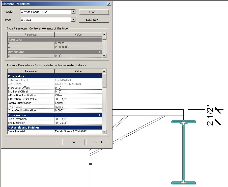

Does anyone know how to keep the symbolic cutback for joists in coarse representation after dropping the beam to suit the under side of bering seat?
I dropped my beams so that the joist seat are on the top of the flange but on plan I loose the cutback distance
any help would be greatly appreciated, as I want to be able to cut sections form the model instead of drafting them out.

In the element properties dialogue box of the beam the joist is resting upon:
1.  Change 'z-direction justification' to 'Other.'
2.  Change 'z-direction offset value' to your joist seat depth.  If it's 2 1/2" you will input a value of negative 2 1/2".
Revit should still recognize these elements as joined.  I'm guessing you were offseting the joist, but it is the beam which needs to be dropped.
See attached image.
Make sense?
