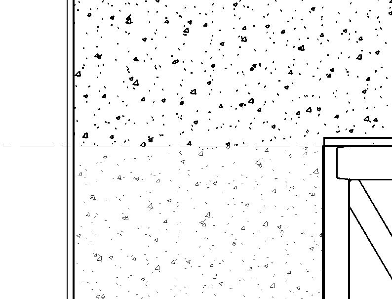

I have a section through my building that cuts through a large concrete column.  The column has odd shape, that varies with the height.  It was modeled using in-place extruded column family for part of it, and in-place extruded wall family for another part of it.  I don't know why the two portions were made with different types (wall vs column).

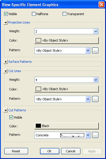

The problem is the concrete hatch in the two portions has different line weights.  In one portion, it is normal.  But in the other portion, the hatch lineweight is much heavier.  I have tried everything I can think of, short of deleting and redoing the columns, to fix it.  I have even tried overriding the graphics for both items, and setting exactly the same settings on both.  But nothing changes it.  I have attached a file showing how it looks.  I also attached a screen cap showing my override settings.  They are identical for both parts.

I am guessing that one element is projecting while the other one is being cut through.
What happens if you over-ride the cut and project to have the same numbers?
Are the materials the same?
You could also use a filled region to make correct.
It looks like a view depth problem.

You are thinking along the same lines as I was.  Both are the same material.  Both are being cut through.  I did override both by elements and set exactly the same overrides for everything.  Same result.
I got so frustrated by it that i finally just deleted the darker one, and made a new one using the same type of in-place family (column) for the new one.  now it works just fine.  but i would sure like to know why they were different.

Right.  But when you were overiding the elements you assigned different values for cut and projection.  Your cut was set to 4 while your projection was set to 2.  I'm guessing if you assigned a value of 4 to both cut and projection you will see the same hatch pattern.

I had the same issue today, my workaround was to hide one type & draw the other one over it. Not Ideal I know but got the job done.
