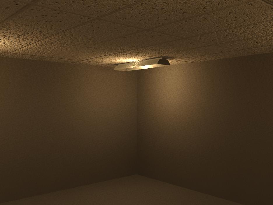

How about now, 2011, I download an IES file for my light fixture, then put it in my family, render it, and I have light coming out the side of my light.  I've adjusted thru full 360° spectrum on the tilt parameter.  If my image was attached properly, you should see the issue.  I'll keep searching thru other threads, but this one was fairly close to my issue.  Also of note, I've moved the light source higher, lower, etc. without much change, darn thing still shines thru the fixture itself.

image i think you have an ies similar to the number 26 or 27 , BUT its pointing to the side. Try to rotating it manually on an elevation
