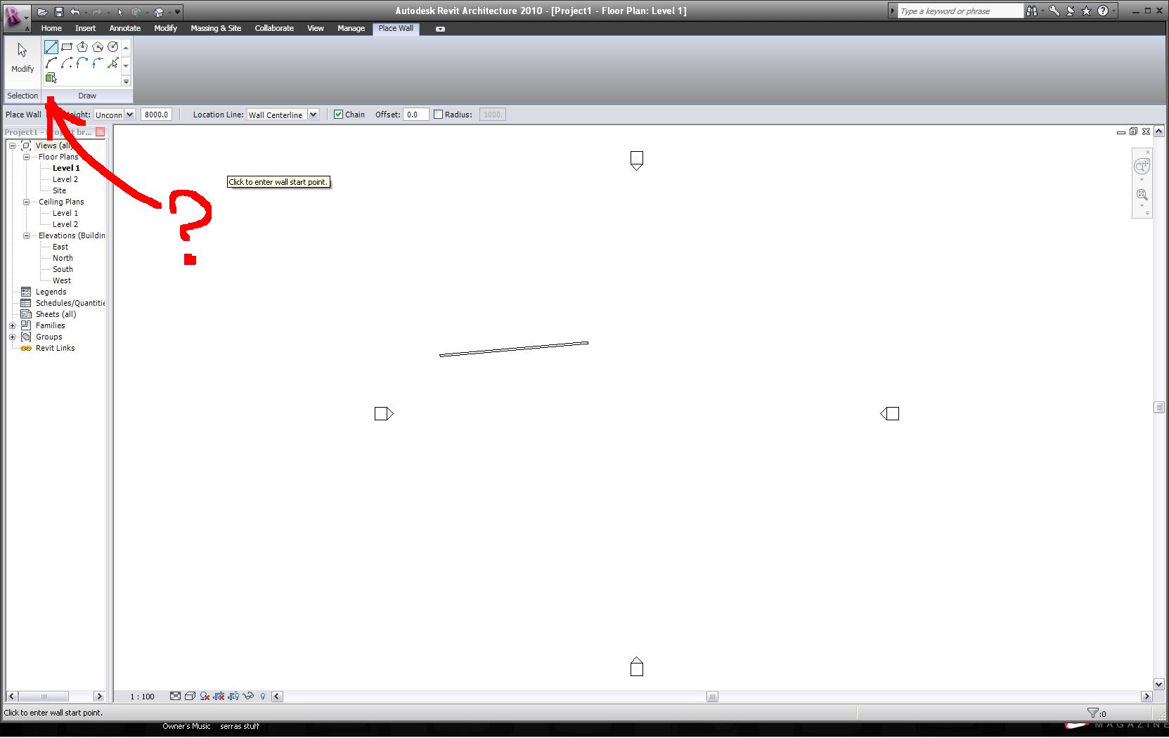

Im trying to learn Revit on my own and found that I am missing some boxes. For example, When I go to "home" and see the wall pull down, if i click on a wall, either just "wall" or "structural wall" i only get two boxes. "Selection" (with the modify arrow in it), and "Draw" (with the options of straight line, rectangle etc.)
Should there not be an "elements property" box? I do not know how to fix this. See attached image.
Any help would be good. Thanks!

I'm not sure how that happened, but the help suggests that you can reset the ribbon by doing the following:
  • delete the UIState.dat file located in the Autodesk Revit Architecture 2010 folder under one of the following folders:
    • For Windows XP:
      %USERPROFILE%\Local Settings\Application Data\Autodesk\Revit
    • For Windows Vista:
      %LOCALAPPDATA%\Autodesk\Revit
