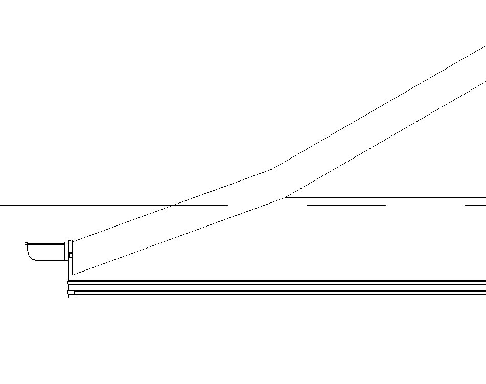

Hi Mr Spot, That's what I thought. It should be simple. I have attached a part plan showing the roofs over a walkway connecting into a pavillion building, 3D view to help clarrify what the roofs are doing and a typical section through the eave. The eave as you can see is a split pitch to the main roof. I created the eave using a fascia profile element and then created a custom gutter profile to attach to it. All of these elements whether they are part of the pavillion roof or walkway roofs sit on the exact same pitching plate height and all with the same pitch. I would like the roofs to be joined to represent what will actually happen at these junctions(there is no ceiling) and also to get the fascias and gutters to mitre correctly. At the moment the fascias and gutter run through each other at exactly the same position. I have tried forming the roof to the walkways as one sketch but Revit thinks this to difficult to do and stops generating the roof. I am forced to create the walkway roofs in a number of parts. Your guidence is appreciated. cadjockey

Okay now i see. You are going to basically have two roofs here (1 for each pitch). I don't recommend creating the lower angled roof as a profile, create it as a roof. You are going to have issues with the joining of these two roofs. You would need to have the lower roof overlap this roof then use a void in-place family to cut the overlapping sections so the join shows correctly in section. You'll then be able to apply the gutters and fascias to an actual roof edge and have them mitre correctly. I'll upload an example shortly.

Hi Mr Spot, I tried opening the file you attachd however there is a compatibility problem. I am using version 7. I tried creating the roof this way the very first time. What I found was that the roofs did not miter correctly at the change of pitch location in section. Especially when I set the visibilty to fine in order to see the structure. This is when I created the fascia that would attach and show the roof changing pitch at the wall plate. I am please with how the gutter has worked though. Our office designs alot of tropical resorts with intricate detailing and roof designs. Hence my wanting to be confident that revit can handle the roofs we require to create. If you could send your file again it would be greatly appreciated. Thanks for your time and patience. cadjockey

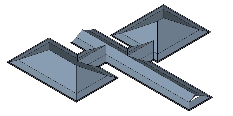

its not an external family, its an in-place family. Follow the exact steps as previously outlined. Modelling tab-->Create

Plan view.

Roof Section.
