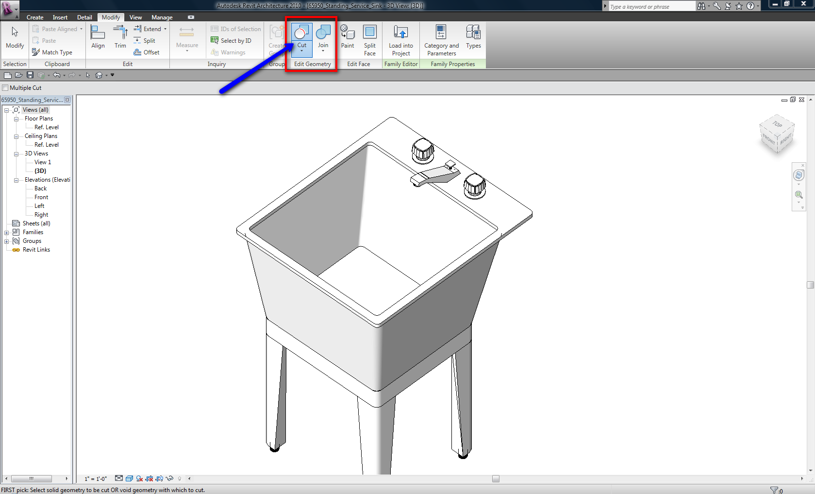

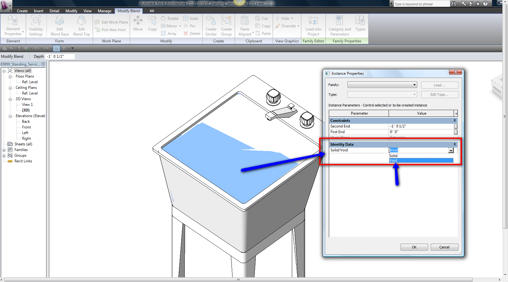

 I am new to revit and I forgot to change my center blend in the middle of the tub to a void but even after I change it to a void it still does not subtract from the solid. What am I doing wrong? Can anyone tell me how to correct this issue? Thanks In Advance

1st- Click your center blend and go to its properties
2nd- In Identity data change to Void
3rd- With your new void selected, go to Modify-->Cut Geometry, click the void and then your exterior blend

Thank you so much it worked perfectly.
