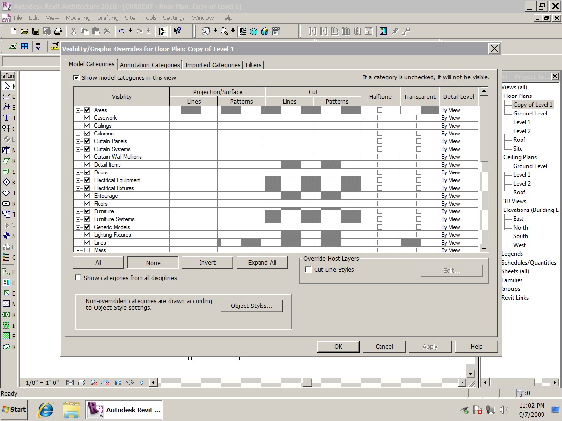

i've always wanted to turn off all the categories
in visability graphics and then just turn on the
categories i want to see for a duplicated view..
but that button that says "none" does nothing..
see attach..

The 'None' button selects none.  It doesn't switch them off.  To switch them all off, select 'All' and then uncheck one button.  They will all switch off.

yeah i think i got it.. i read the help over and over
and only found it by accident..
