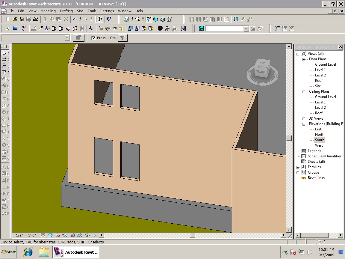

all the tutorials i've seen say to put a curtain wall
in like it was a wall in plan view..
and everytime i ask this question here
they say it's easier if i do it in plan view..
please look at my image.. i know i could
cut those holes in plan view and check embedded
and make the curtain wall window..
but i want to cut the hole in the wall and then
put the curtain wall in the hole.. i have my reasons..
is this possible?

You can if you want to.  Draw the wall in plan view, probably outside the wall so that you can see what is happening and in elevation, align it to the opening.  In plan move it to the correct position.

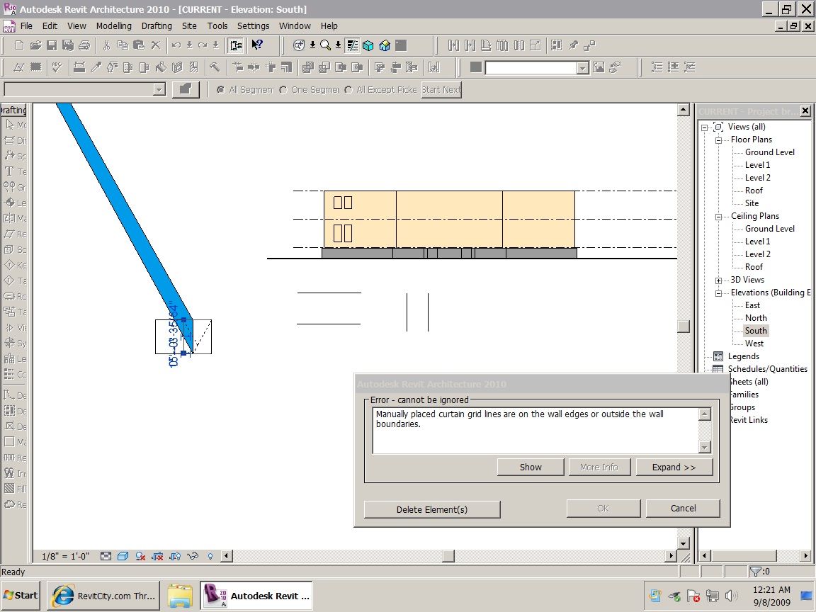

seems like it might be possible to make a curtain wall
in an elevation view using lines somehow..
it does have curtain system by lines- that must
mean something..

there is some curtain wall creation activity
in elevation view- it must be there..
see image..

Here's what I would try and do...
In plan view, draw the curtain wall outside of the wall with the opening and maybe a little to one side of the opening so you can see the opening in an elevation view.
Set the curtain wall to use a base constraint the same as the wall with the opening.
In elevation view, use 'DI' to get the dimensions of the opening (if need be; I'm presuming you already know this though) and if needed for the bottom of the opening from the base constraint.
Use these dimensions for the curtain wall and offset the base constraint to that of the bottom of the opening.
For the top constraint leave it 'Unconstrained' (I believe that is what it is called) and give it the height of your opening.
Then use plan view again to move it into place.
Hope that helps.

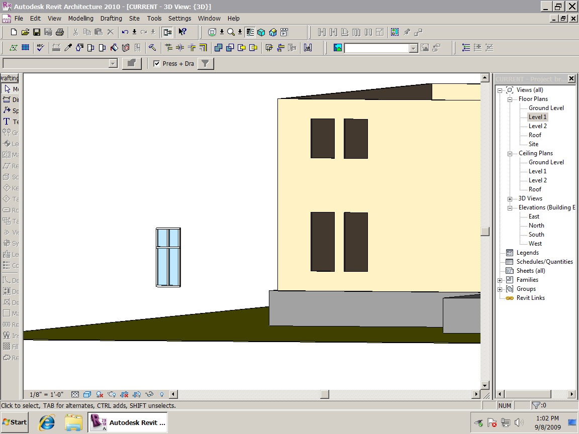

curtain wall window created in elevation with detail lines
and then viewed in 3d- with strange behavior..

So you don't need any assistance creating the holes by the sounds of things.  Just placing the curtain wall in the openings.
This can be done in 3D no problem.  Just set the base of the wall and top of the wall to match the head and sill height.  Then draw it on the centreline of the host wall to the extents needed.  It should snap where appropriate.

Mr. Spot- i think i found a way to create curtain wall
windows in elevation.. embed a small square curtain
wall in the general location from a plan view and
then go to elevation and edit the profile there..
i found i can change grids and mullions in elevation..
what's nice about revit is there is so many ways to
do things that almost anything can be done any way
you want to do it..
