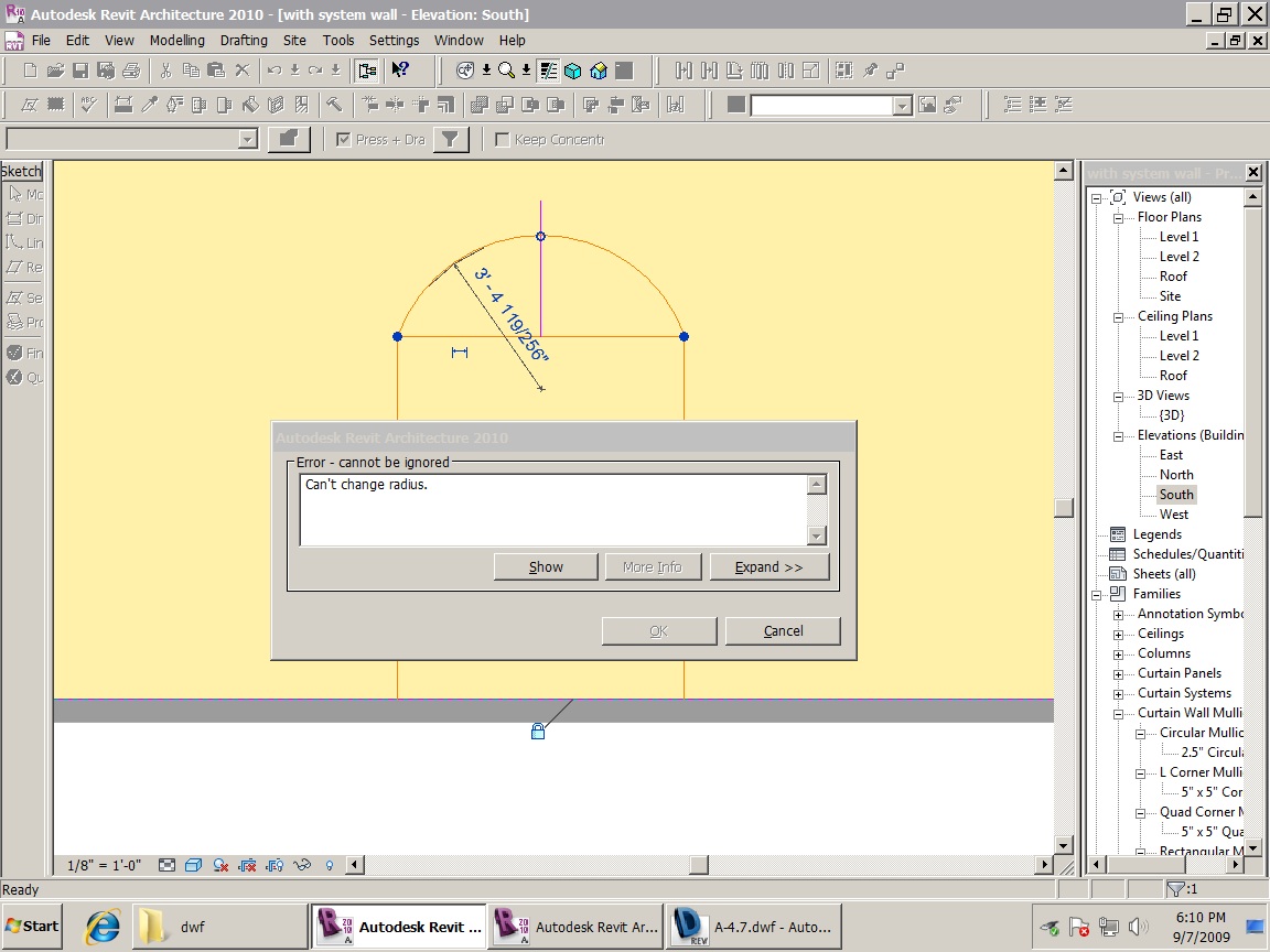

i'm trying to put a curve on top of this rectangle..
but it only wants to snap to a half circle with a radius
of 3' 2"--- i want the top of the curve to be 3' at the top
of that center line.. if i type in a different radius i get
an error.. i can stop it at several positions below the
top of that line- but i can't change the radius number
or make the top of the curve snap to the top of that
center line..

Draw a ref plane at the where you want the top of the curve.  It will snap to that.

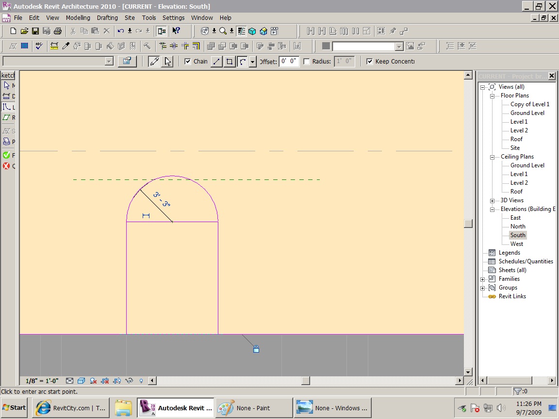

see the image- it only snaps to a half circle- it won't
snap to a reference plane..

Draw a vertical ref plane on the centreline and use snap overides to snap to the intersection (type SI).

Simple ... use a three point arc and on your options bar, select radius and enter the 3' dimension.  Now pick your line ends.
You have to pay attention to those darn options !
