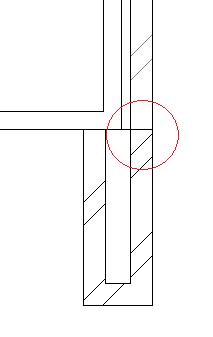

How do I join these 2 walls?

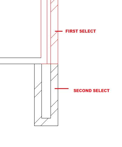

Rudyard, not sure if this makes sense!
I selected the Join Geometry tool, proceeded to select my FIRST solid geometry (being the brick veneer) then it asks to select the SECOND solid geometry (being my single brick with the return) however when I try selecting the single brick wall, it won’t let me select it.
Any ideas why...?

To better understand I've attached an image.

Do you have the same "material" in the 2 walls?? What i'm trying to tell you is, the "Material" must have the SAME NAME, you can have in the "Settings>Materials" 2 or more "names" with the same material but to join the walls like you want you must have in the 2 walls the SAME NAME to that material, did you understand???

Typhoon,
That’s exactly what my problem was. The extended wall was a different material type to the brick veneer.

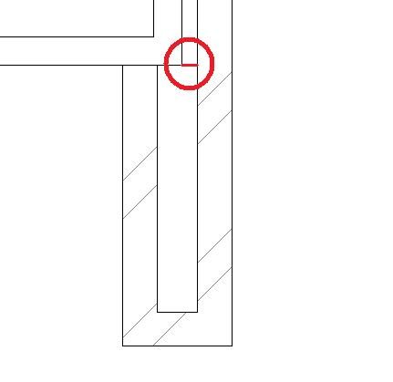

Now that I have that sorted, how do I remove the RED line I’ve circled?

Use the "Linework" tool, choose "Invisible lines" and pick in that line once or twice until disapear....
