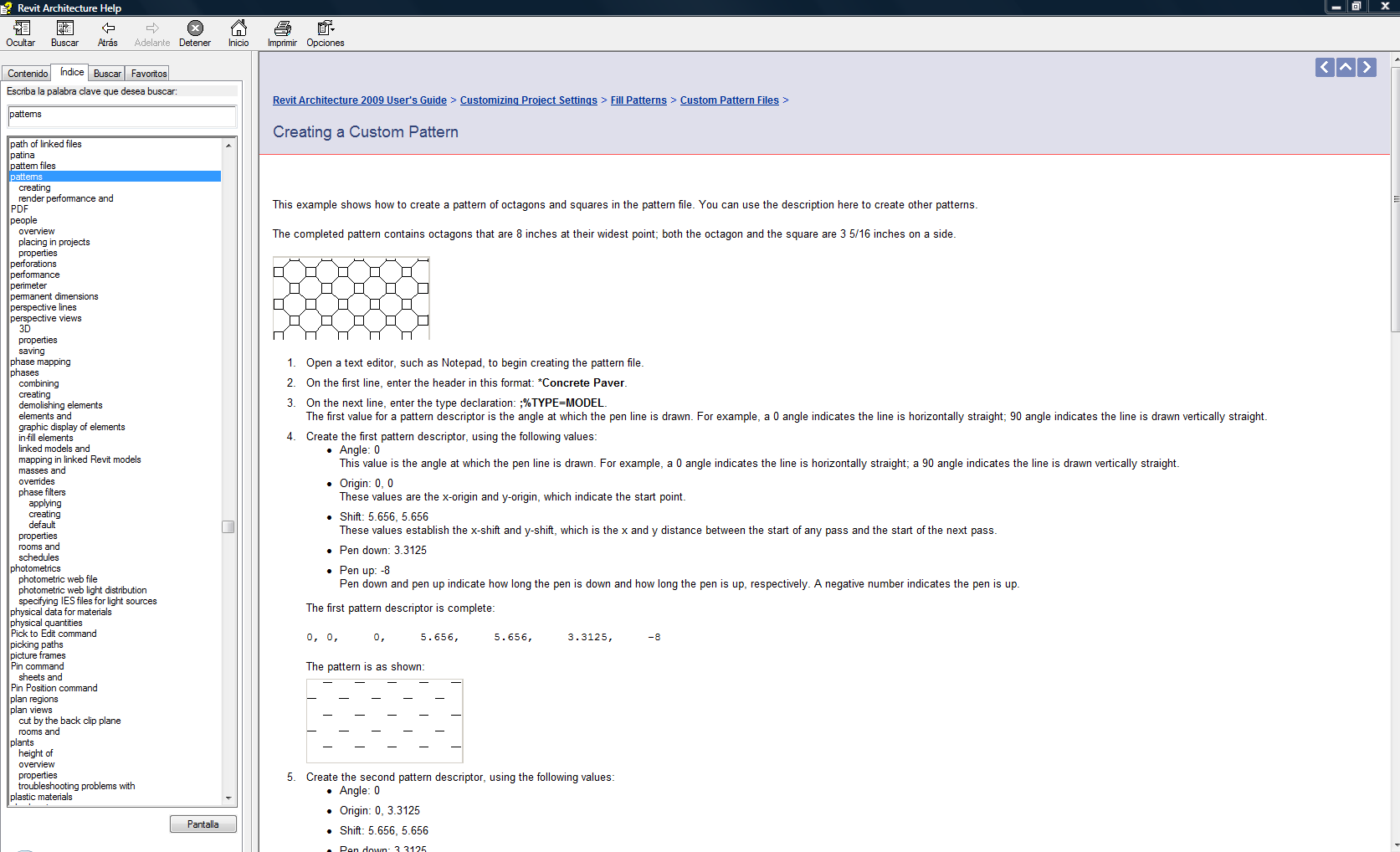

If it's the former, you can create simple patterns, such as rectangular tiles easily in Fill Patterns, or more complicated ones by defining them in the pat file as suggested by Erland.  The attached PDF gives a better explanation on how to define these (I created this to remind myself as it can be a bit complicated).  Alternatively, you can import AutoCAD hatches.

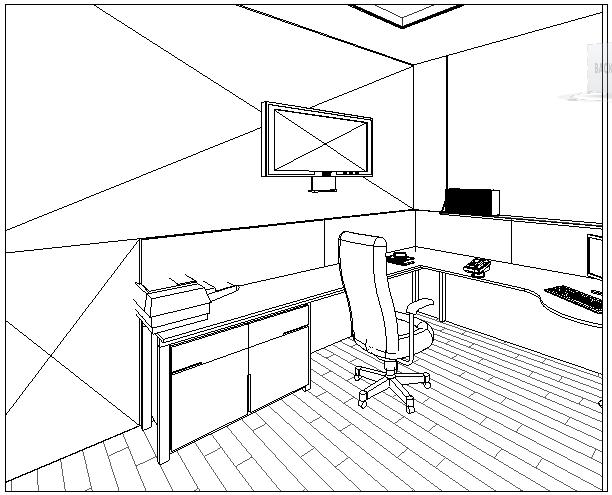

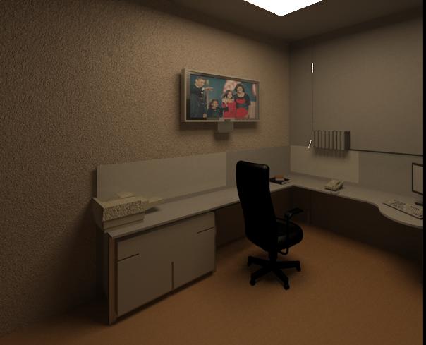

I did some reading and experimenting.  I used decal to put the Obama Family on the TV and the attached cliffstone to the wall.  Then I used split face and paint to add cherry wood & the wood planks design to the floor.  The cliffstone decal and the wood planks didn't come out when I rendered. Help anyone?

Why you use "Decals" to put "materials" in the wall or floor??? I don't get it, you can apply that material "Cliffstone" to the "layer" of the wall.... and the wood planks design to the floor (material also, NOT decal)....

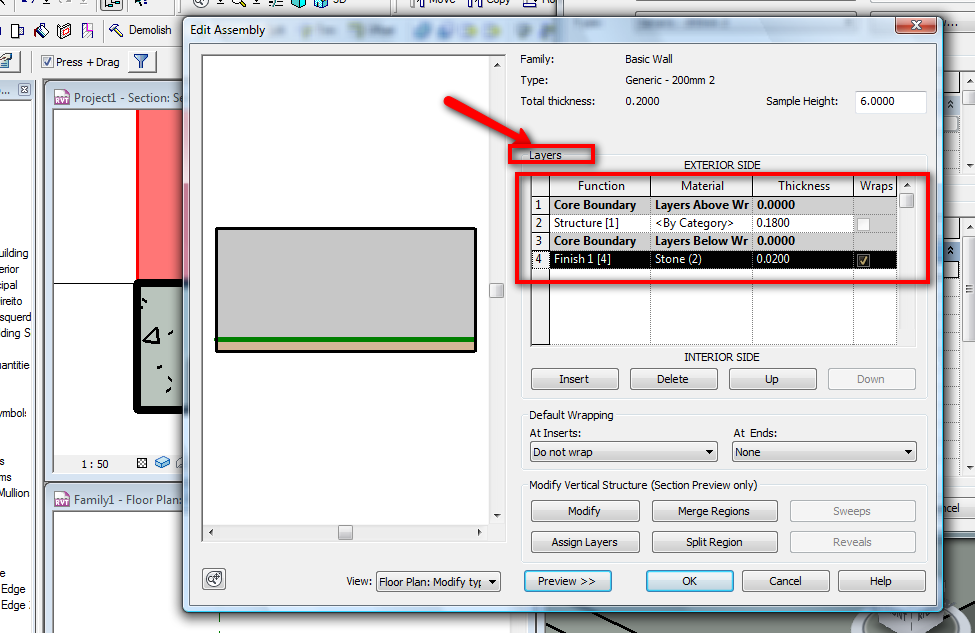

This is a "Layer".... pick in the wall and go to the properties, Edit/new.... check the help menu how you can create a wall with several layers/functions....

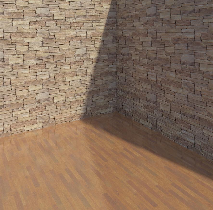

Looking up layers in the help menu got me lost in learning new language and terms.   However I think I got it on the walls.  Still working on isolating one room on the floor.

Click on your wall and check element properties, EDIT/NEW, edit structure and then in the Edit Assembly change or assign material/s to your wall finish (interior and exterior). Same procedure with your floor finish. Hope this helps.
