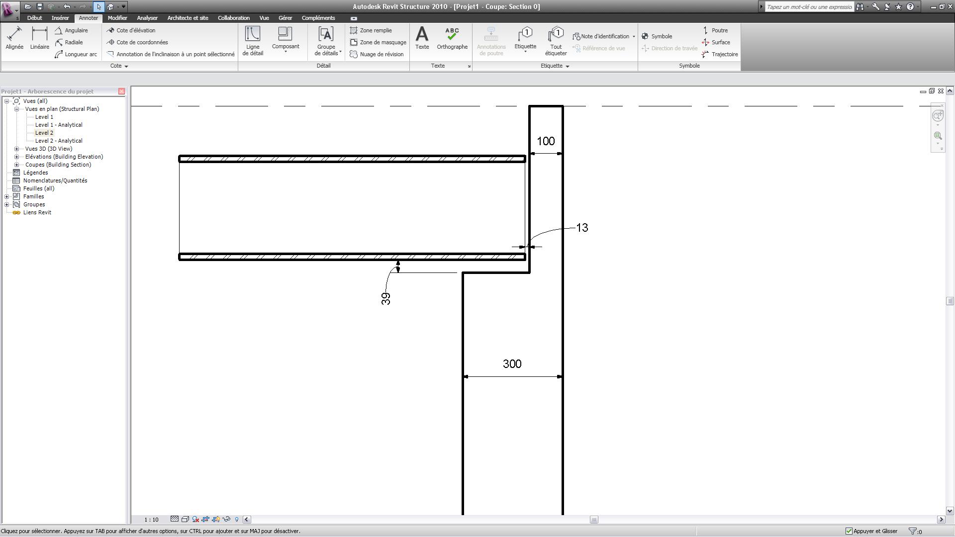

heres a solution! this is a component,a simple rectancular void form, but is totally worth having when beam are places in concrete walls for exemple.
I have trouble myself to use it, it seems to forget what is the host, so once installed in wall click "new pick" to select host again, and you should see the pocket in wall for your beam or joist.

Hi Canadian Lizzard,
Your family work perfect, i just don't know how to get the representation we required on plan. please see attached image.
I already did some attemps with masking redion od nested components and nothing.
