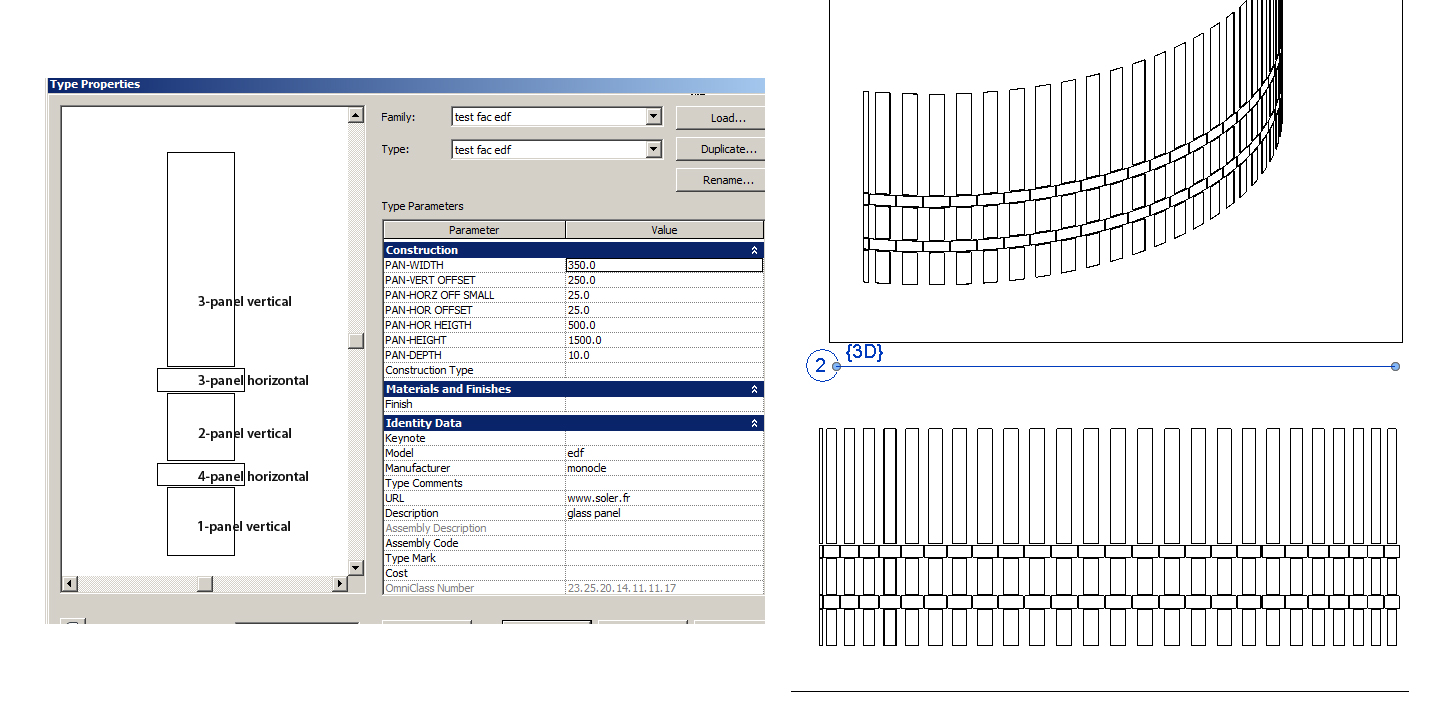

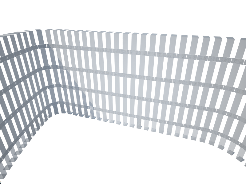

I am trying to develop a façade like the one you can see in the attached image...
starting from a curtain wall, I need to divide it full/empty space and this panels are made of glass.
I thought curtain walls could be the way, but I am having a lot of problems.
any suggestion?

Use the "Conceptual Mass" to create that kind of CW.
Well... with a little work you can do that too with CW family....

ok, but:
1-I made it as conceptual mass, but then how can i used inside my revit project? in order to count each part of the structure? assigning material -are glass panels- and specification to be be added in the schedule?
2-I think I can design a family as you did, isn't it?, but I don't understand how to use it. it could be very useful to set some parameters: width/height and distance from each panels
3-I am sorry, I am switching from rhino/grasshopper to revit and I am still confused!

found it!!!!
http://autodesk-revit.blogspot.com/2007/08/custom-curtain-wall-panels.html

now I have a new problem: I designed a panel that is made by: 1vertical panel+1small horizontal panel+1vertical panel+1horizontal panel+1vertical panel
when I designed my cw with my custum panel revit is coounting into the schedule the "composite panel 1+1+1+1+1" how can I divide the panels? because I would like to count the verticals and the horizontals, since the verticals are not always the same, and the horizontal off course are different.
I hope the image will help you.
regards.
