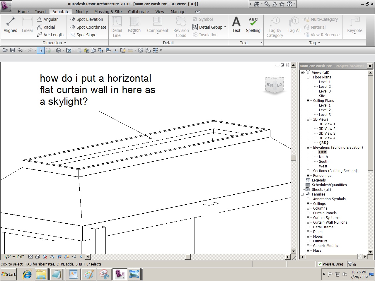

see attachment for question- thanks..

Draw it as a flat roof and then change the roof type tp 'Sloped glazing'.

that sounds simple enough- thanks tim i'll give that a try..
