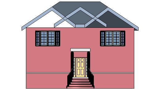

It seems this problem should be so easy to sole but I have been surfing for hour at no avail. If anyone would be so kind to help me out. it would be greatly appreciated.
I am trying to trim the middle roof so that it will blend with the other two flanking it.

If it was drawn as a footprint, draw reference lines at the intersections and edit the roof in plan to trim at the reference planes.
If the roof was drawn by extrusion, edit in elevation.
I'm not sure if this what you mean?

It was drawn as a foot print. The Cut off level trims the wrong side of the roof. I will try the reference lines. thanks

Thanks!!!!!!!!!!!!! I went with the extrusion route. Worked like a charm.
