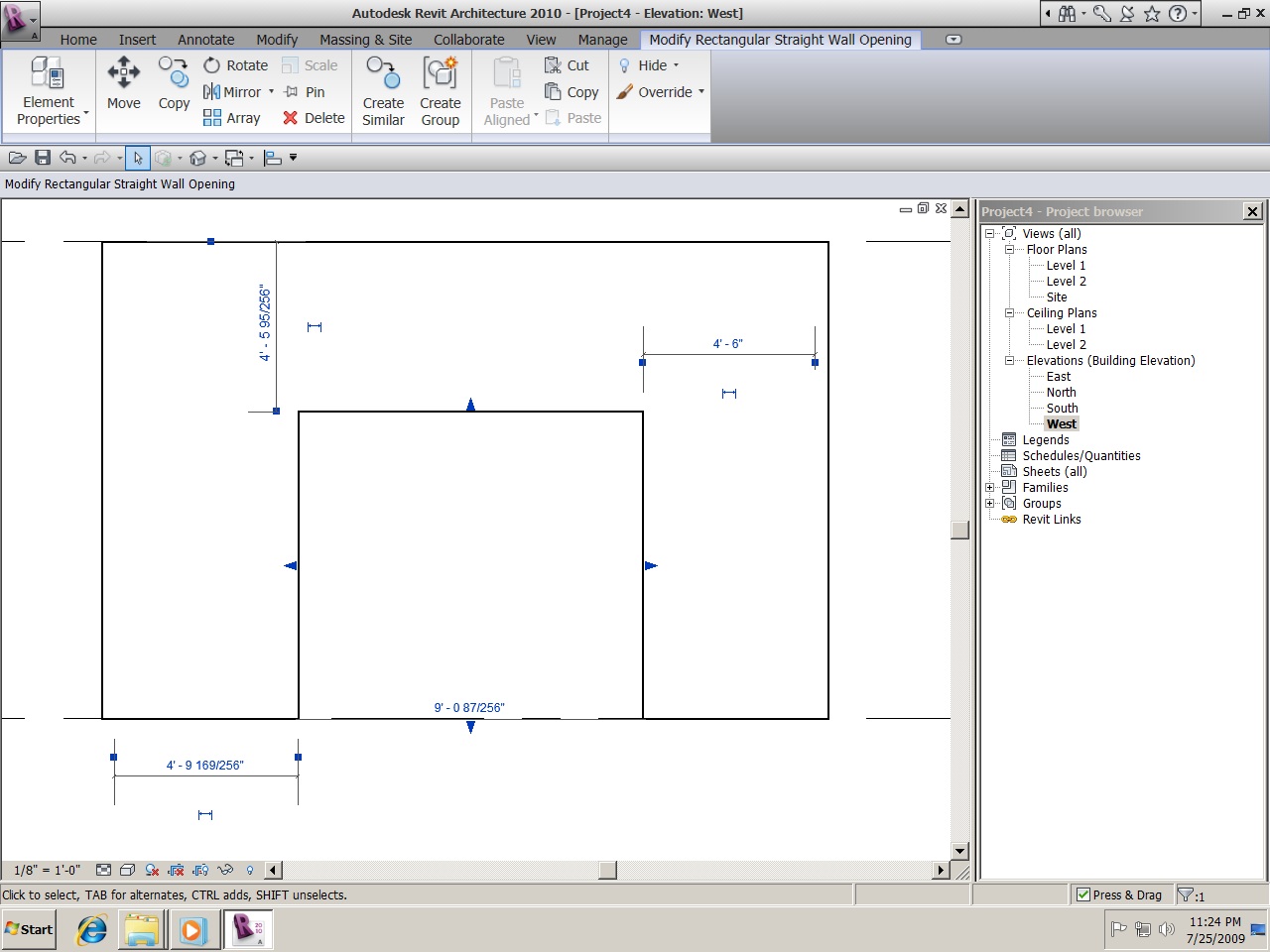

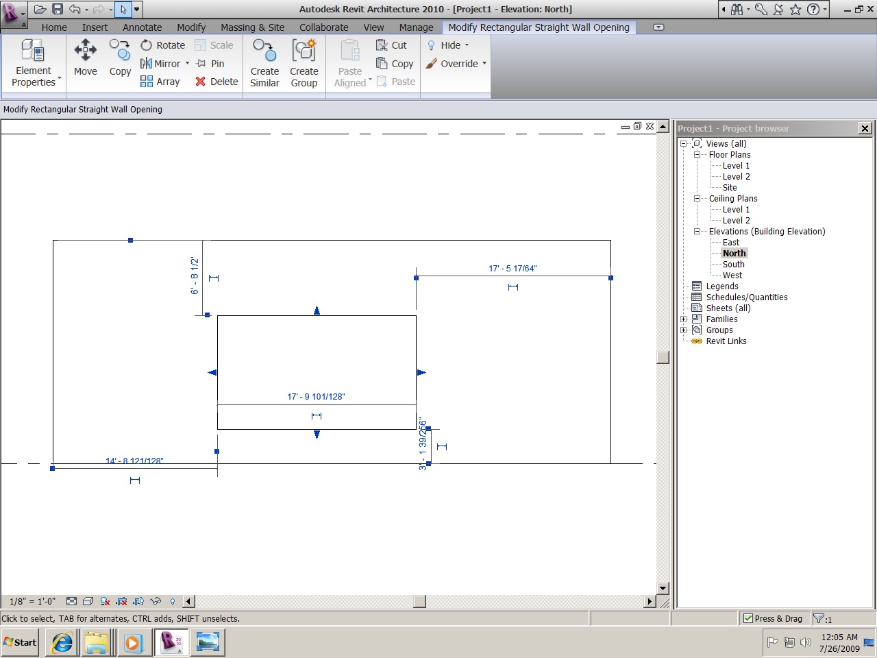

there i am in the wall opening context menu..
i drew the opening on the wall..
i get some grips and some temporary dimensions..
there is no measuring tools of any kind on the context ribbon..
somebody please tell me how you would maneuver this opening
into the place you want it.. i want it center on that wall horizontally
and 10 feet wide and 9 feet high.. i sure can't drag those grips
and guess- and i don't see all the temp dimensions i need..
please see my attachment..
i might as well throw away another four years of my life on
revit and get nowhere..

Create reference planes and use the align tool to line them up.

I've always used shortcut keys - RP for reference plane and AL for align, but Reference plane is on the Home tab and Align is on the Modify tab.

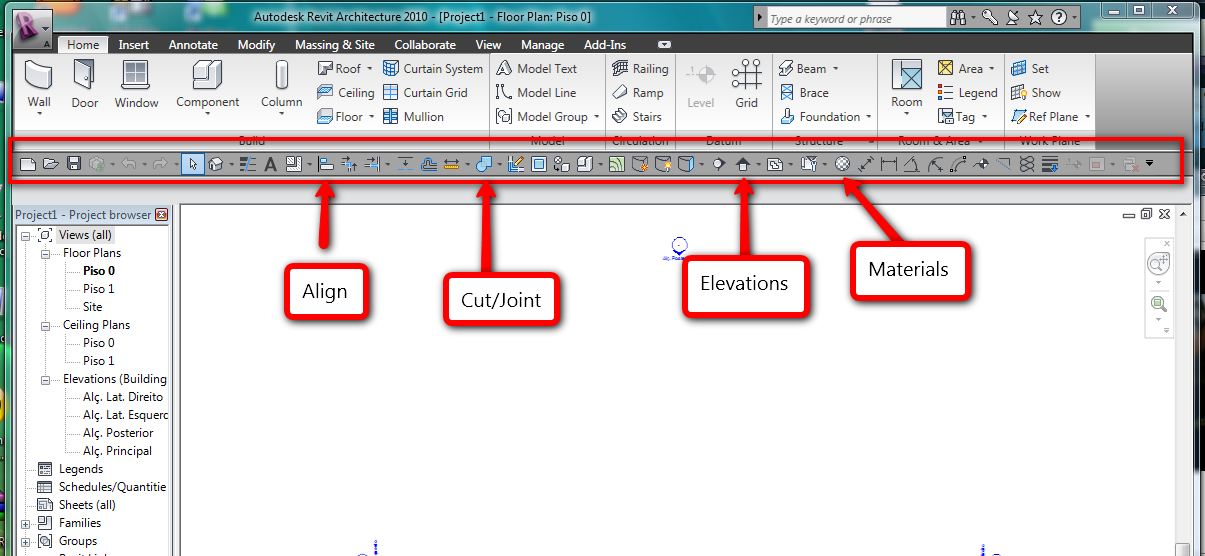

I'm with TIM too, and you forgot one thing WYS, why don't you put in the Ribbon the "Commands" you use more often?? You can do that, so in this way you don't spend time to search in menus for them....

yes Typhoon- that's why they created the QAT..
i think i like your style Typhoon..
don't fight it- just use it like they intended it to be used..
some keyboard functions- tools on the QAT from one
side to the other and the ribbon.. why not?
