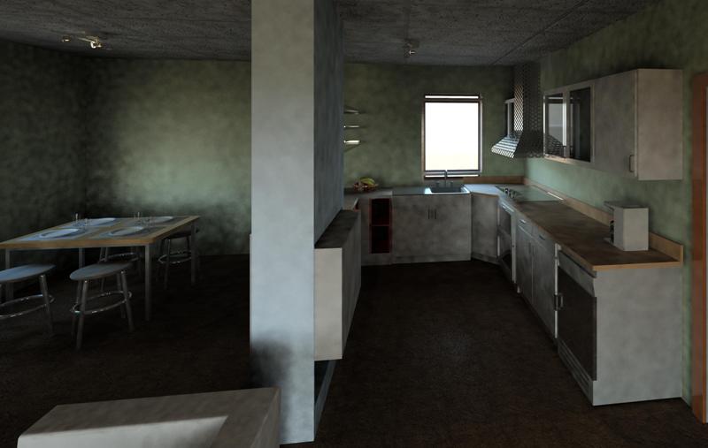

 I am trying out revit architecture 2010 and I have found several problems I cannot overcome myself.
1. My renderings look bad ( the walls and other surfaces are blotchy), see image file. I think it has to do something with lightning, because when I remove the roof, renderings look ok.

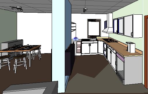

2. I cannot see any texture in the camera view before rendering. I always have to render at least in draft, to see any form of result. And that is annoying. In programs like Chief Architect I always see some form of result when I am in the camera mode and in revit I just see the plain colour of the texture ( see image file)

Your renderings can be improved substantially by getting the lighting right.  Try adding some lights.  Depending on the sun angles, if you hide the walls behind the camera you can also get some good results.  Most of the renderings in the gallery were done in Revit and some are quite impressive.
You can check the textures of materials in the material editor and get a good idea of how they will appear.  The draft render gives a good idea of the lighting, but to really see the materials, you need to do proper renderings.
