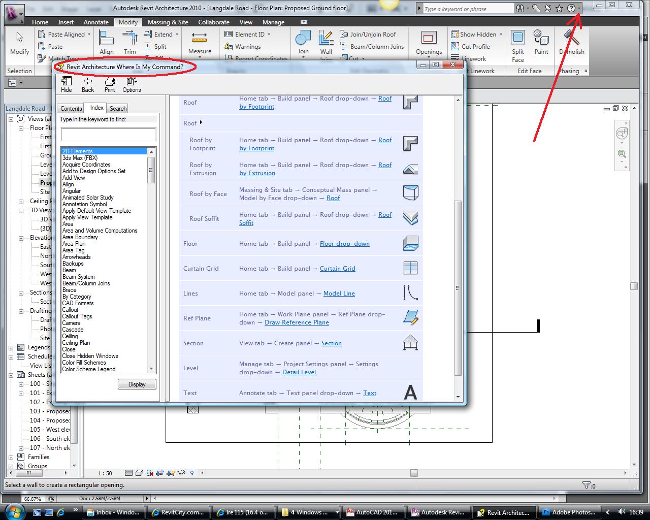

That's a very clever work-around! I have both RAC 2009 and RAC 2010. I'd be using 2010 except that I'm in the 11th hour on a project and 2010's new interface so far has been an exercise in frustration! Maybe I'll use it on the next project, but I'd guess that I'll burn up days learning thenew interface. BTW this is a useful web-based aid to figure out where the commands where moved to in 2010: http://www.nichitecture.com/downloads/Where%20is%20my%20command%20in%20Revit%20Architecture%202010.html

Ther's also a 'Where is my command' help item in the drop down menu next to the help button in Revit. Not as pretty, but it shows where all the previous commands can be found.
