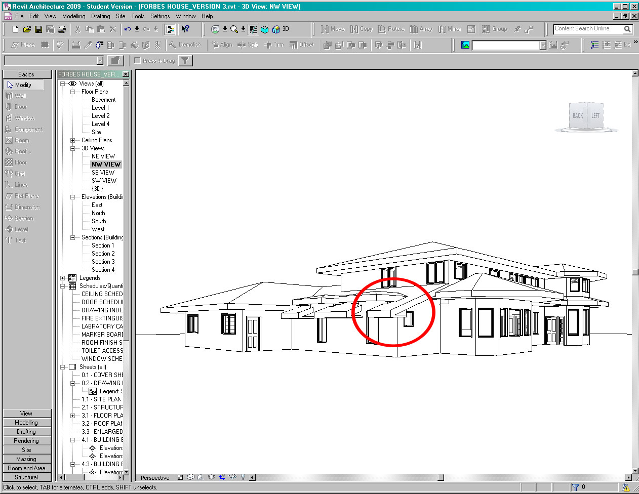

I was wondering if there is any way to build this soffit detail without any extra lines.  I am trying to do some simple line perspectives for a client and want this detail shown without any extra lines.

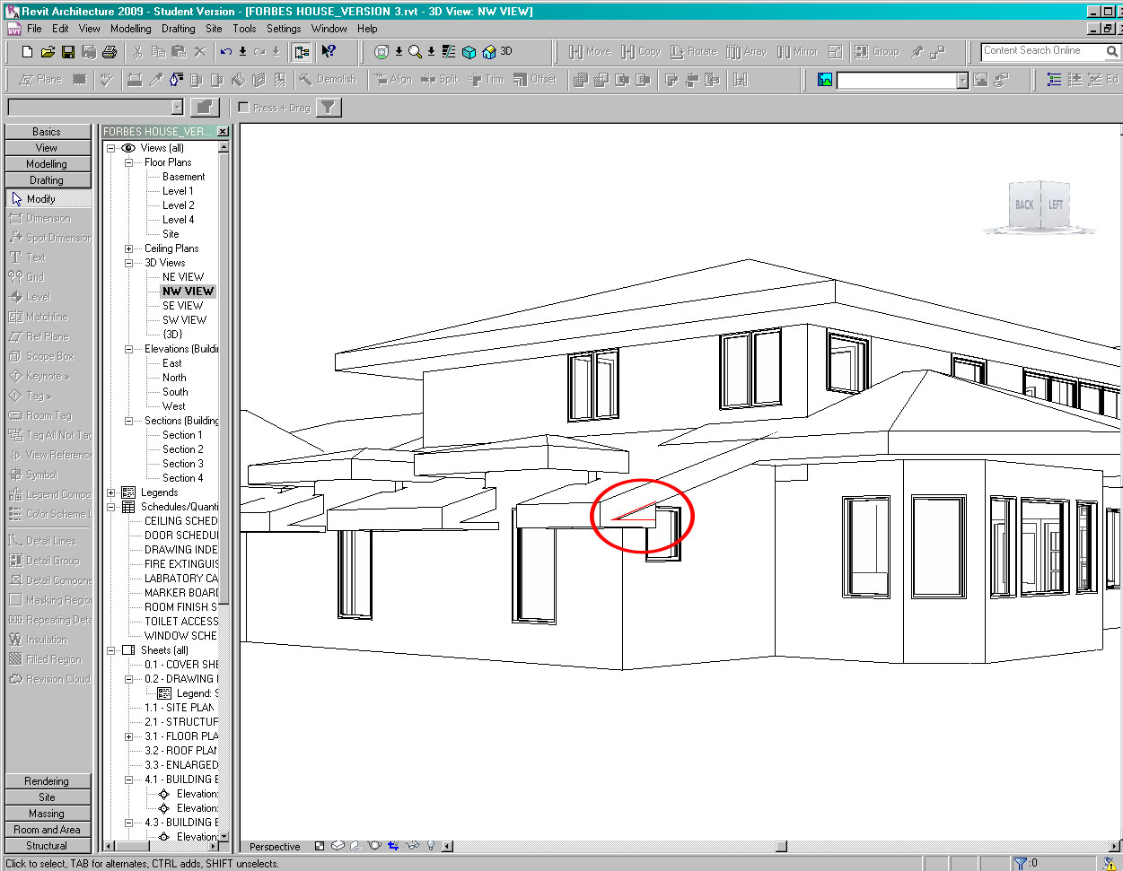

The lines highlighted in red are the ones that I am trying to get rid of.  I have tried to join the geometry, but that doesn't seem to work.

You could try to use the linework tool for invisible lines, then select the lines you don't want to show up.
