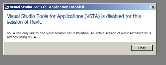

I cant run two sessions of Revit 2010 as I use to do with 2009?
 Gives me this error:
Visual Studio Tools for Applications (VSTA) is disabled for this session of REVIT
VSTA can only link to one Revit Session per installation.An active session of Revit Architecture is already using VSTA
I mean com_on this is really crazy!! So now how am I suppose to open two sessions at once? I use to Render on one while working on other and does this mean I will have to buy two PC's and two licenses if I want to run more than one session?
See the print screen error attached

You can use two sessions simultaneously.  Visual studio is for the programming in Revit.  Ignore the message.
