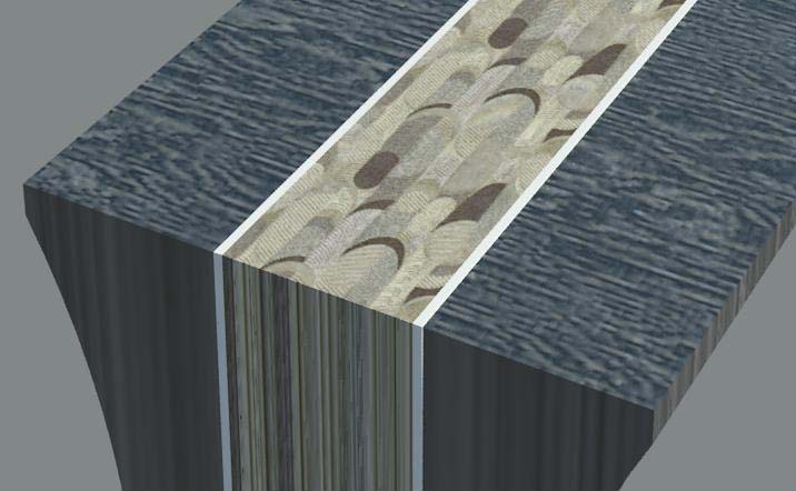

hi can anyone tell me how to make the material render of the flat surface same as the vertical ones??thanks! see attatched image

You can probably make the vertical surface the same as the horizontal surface using the paint tool, but the finish on the vertical surface is not a material, but the material showing depth through the substrate of the material.
If that's really what you want you could create maps from the cut material to create new materials.
