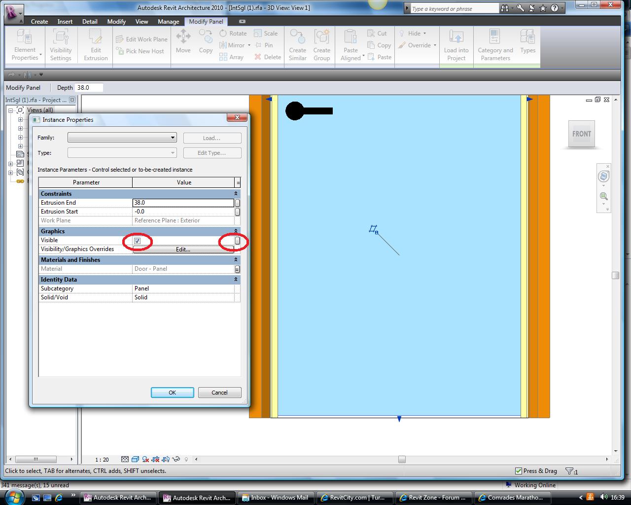

You will need to modify your door family and give the door panel a visibility parameter.  Then change the model door swing lines to be visible in 3D.

I'll try that.  but if I open up a predefined door, where is the parameter for it?  I don't see it.  I see the Visibility graphics, and I go to door but all the layers are on.

Click on the door and the edit family button.  Probably save it as a new family.  Click on the door panel properties and you check wether it is visible or not.  You can switch this off, or add a parameter to switch it on and off by clicking the small button on the right of the field row.
The door swing is a symbolic line so will only show in the plan.  Redraw over it with a model line (If there are two, one is for course and the other for fine).  Click on Load into project.

got it!  Thanks.
