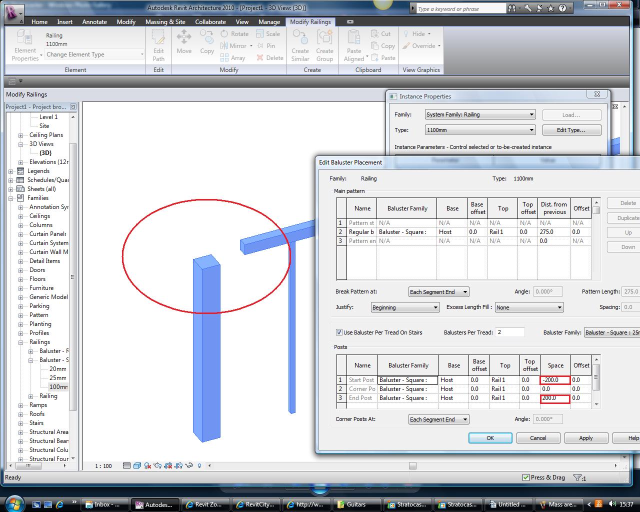

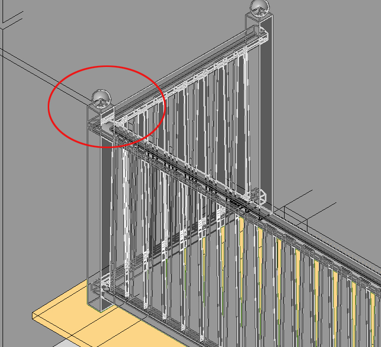

please see image below.
 how do you stop the railing form going though post?  I want the railing to die into the post on each side.

The railings are continuous, so you will need to create two railings for that corner.  You can adjust where the rails end by adjusting the positions of the end posts.
