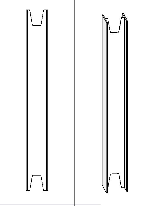

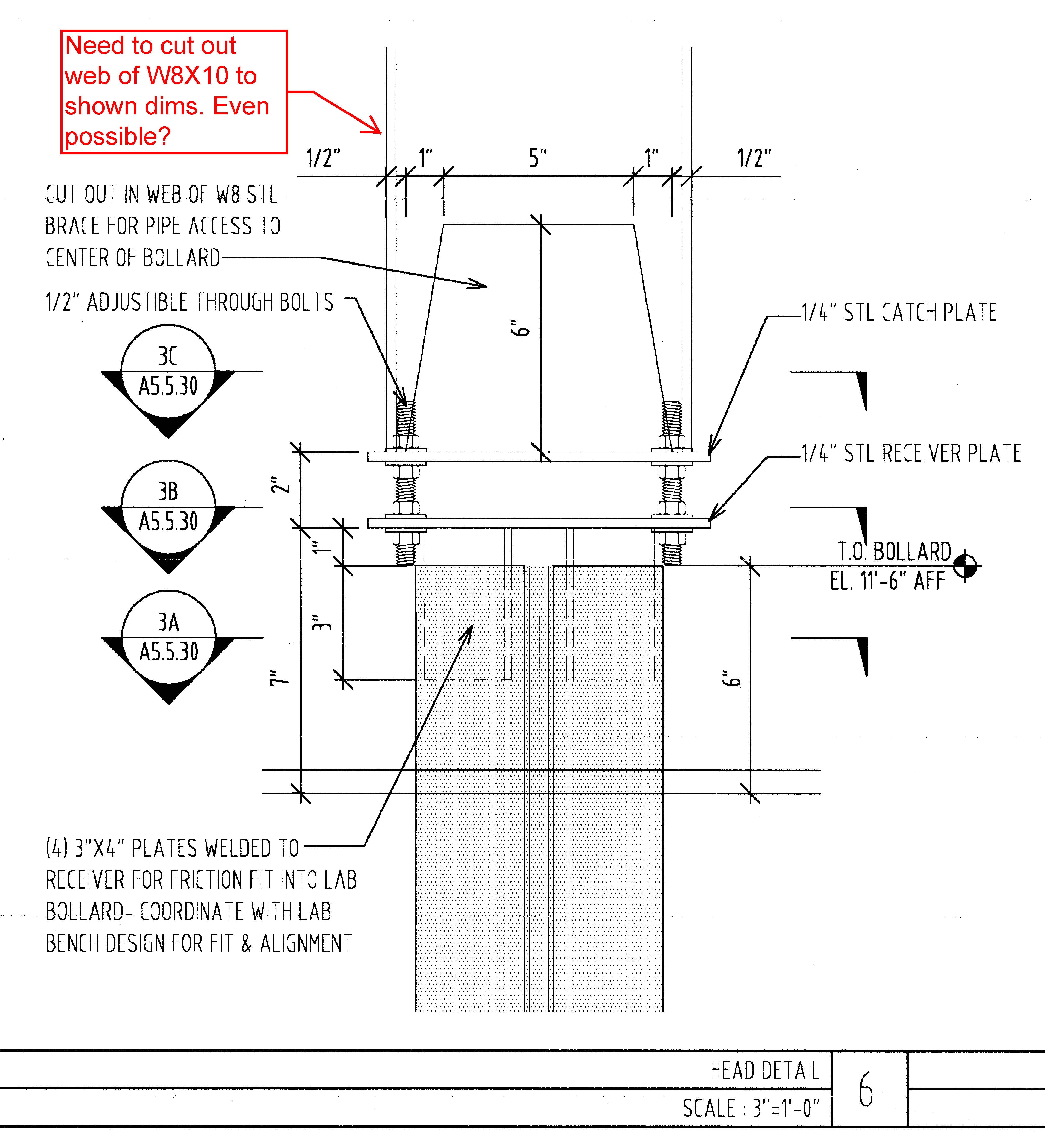

In Rev St '10, how can I cut out a web on a W8X10 to the dims shown on attached file?

Please refer the attchment. I didn't try for the exact dimensions you have specified but the cut out on web is possible using OPENING BY FACE option.
Fri, May 29, 2009 at 1:57:36 PM | web cutout in column
mandrell
Joined: Tue, Mar 17, 2009
2 Posts
Got it, thanks a lot. I am sure somewhere in the back of my mind that was filed incorretly. Lol.
