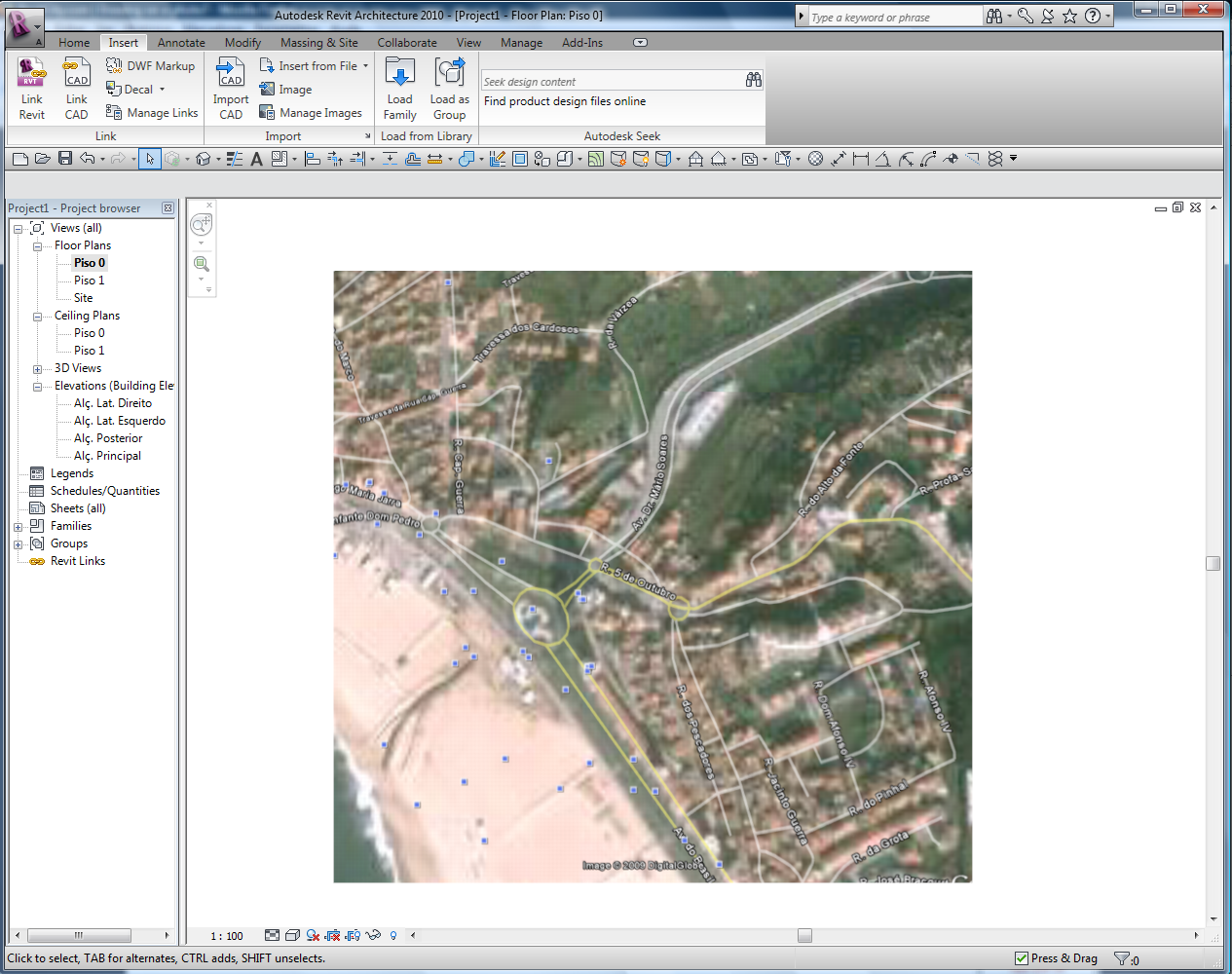

You can insert an image into any 2d view in revit.  Import the image into a site plan or floor plan and scale it to the correct size.

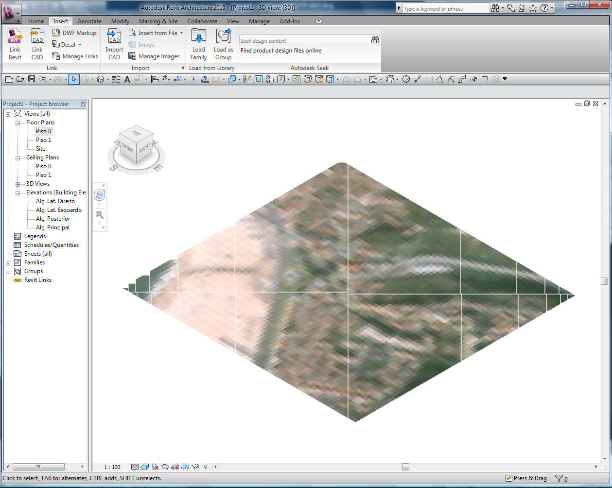

in 3D view, but appears those white lines....
Thu, May 14, 2009 at 1:49:54 PM | Drawing on a photo?
Joined: Tue, May 22, 2007
5921 Posts
4 Stars: 205 Votes
But the problem is it loose resolution if the image is to large like you can see in the first image i post, and revit dont allow to have more than 2 miles...

Typhoon - what are the white lines?  If they are contour lines you can switch them off.
Thu, May 14, 2009 at 2:00:26 PM | Drawing on a photo?
#10
5921 Posts
4 Stars: 205 Votes

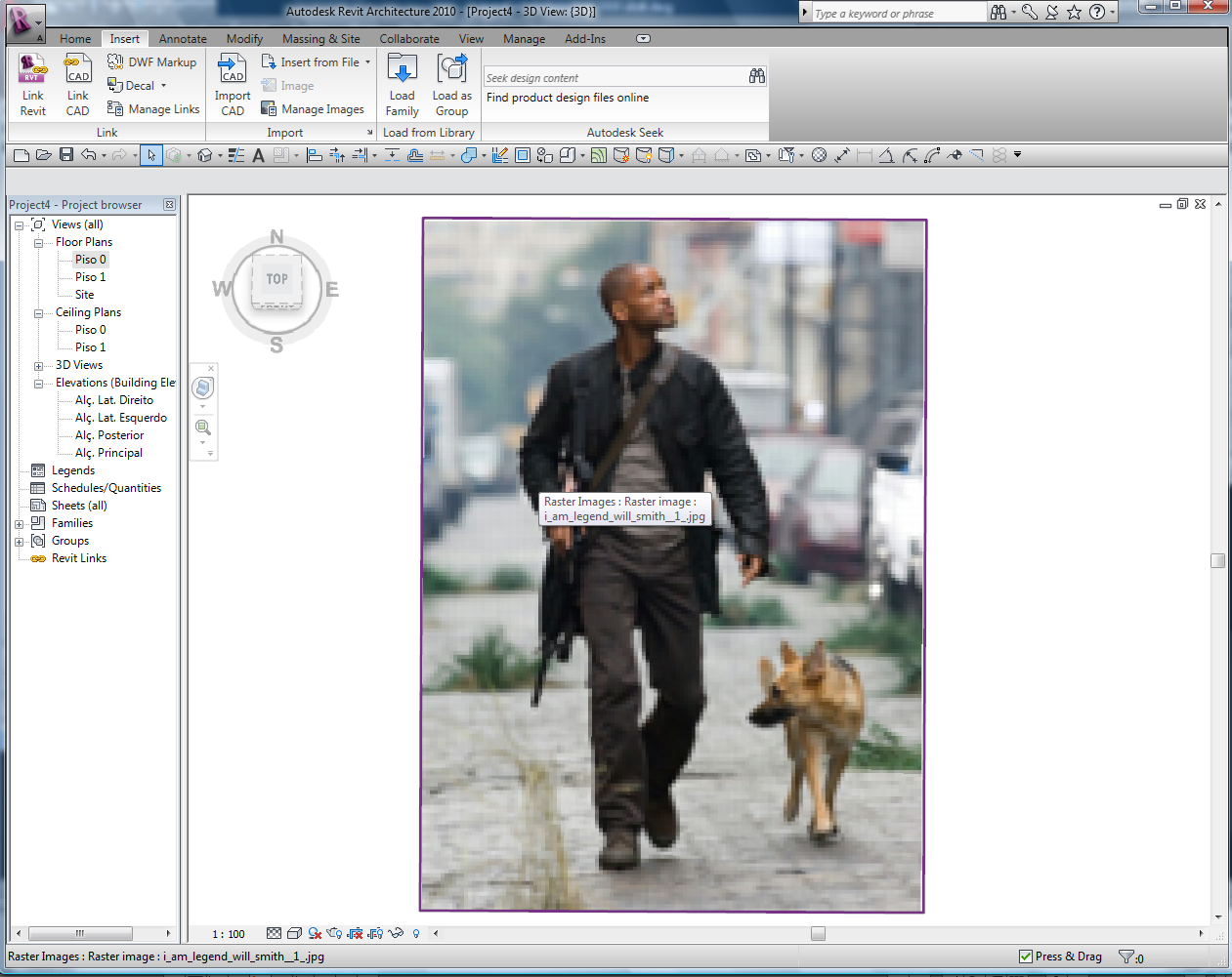

No Tim, it's only an image from google earth, the Will Smith also, just an PNG file....
