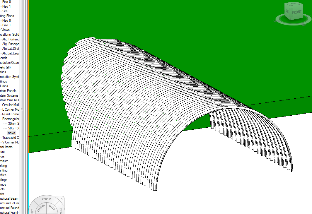

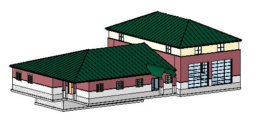

I have a semi circle canopy that needs to have a standng seam.  I used the extrustion method to make the roof.  How do I get the ribs to follow the curve of the roof instead of the direction of the extrusion?  Using RA2009.  I used the method of creating 2 roofs, one over the other with the top one being the sloped glazing, for my main hip roof.

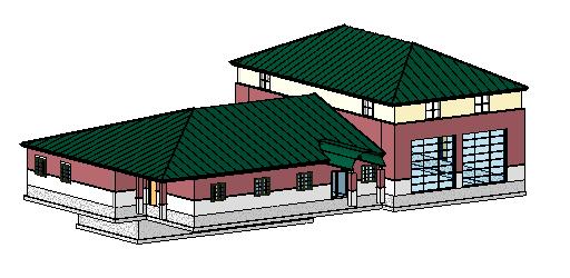

Images of your roof please...

Yeah use the "Sloped Glazing" system, i think it's the best option...

how do i get the "ribs" to follow the curve and not the extrusion?

??? like my image?? do it with the "Sloped Glazing" system....

i think you have to add mullions now to simulate the standing metal seam?

CREATE A NEW "PROFILE FAMILY" WITH THE SHAPE YOU WANT, LOAD INTO THE PROJECT, GO TO THE PROJECT BROWSER/FAMILIES AND EXPAND THE CURTAIN WALL MULLIONS, IN THE RECTANGULAR MULLION EXPAND AND DUPLICATE ONE OF THEM, CHANGE THE NAME AND ENTER IN THE PROPERTIES, CHANGE THE "PROFILE" BY THE NEW YOU JUST CREATE, PICK IN THE ROOF (SLOPED GLAZING) AND GO TO THE PROPERTIES, EDIT/NEW AND CHANGE THE LAYOUT BY THE NEW MULLION YOU JUST CREATE BEFORE, CHANGE THE PROPERTIES YOU NEED (FIXED DISTANCE, OFFSET....).
DONE....

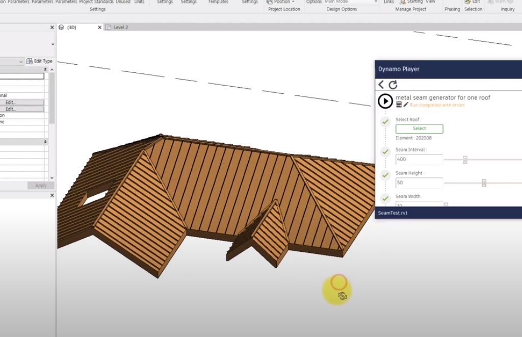

I just created a Dynamo Script which Generate standing seams instantly.
watch my vid here
https://youtu.be/Jj8yrpywut4
