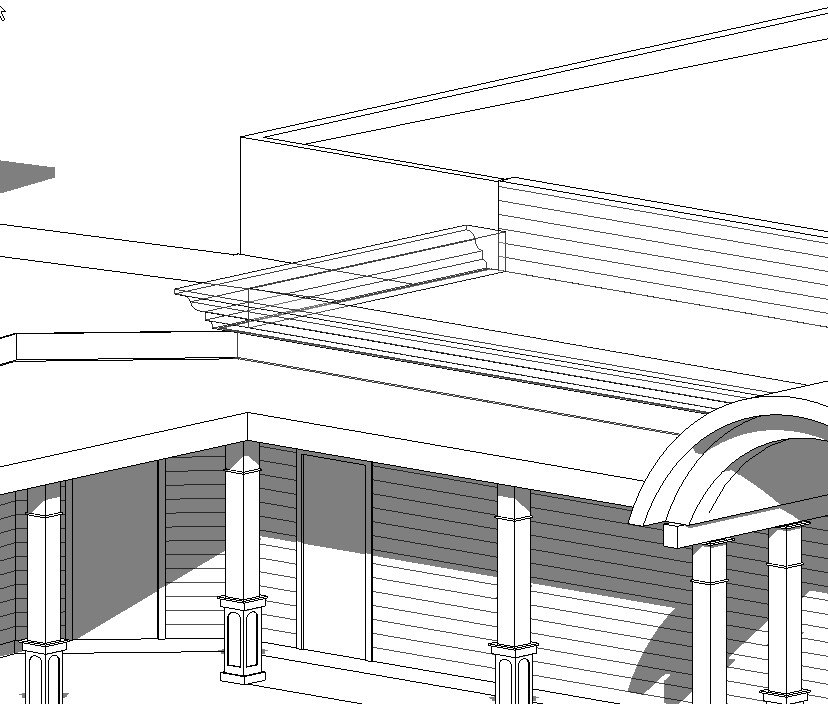

I've been attempting to use the sweep function to create a cornice around the top of a building (and other things), however the finished product ends up transparent with no shadows cast (see image).
Suggestions?

Are you doing it as a mass?  If so, rather create the component in a category, such as walls.

I would have created the curved roof as a roof and not a mass.  You can model it in the same way that you did the mass.  Create an in-place component and give it the roof category.

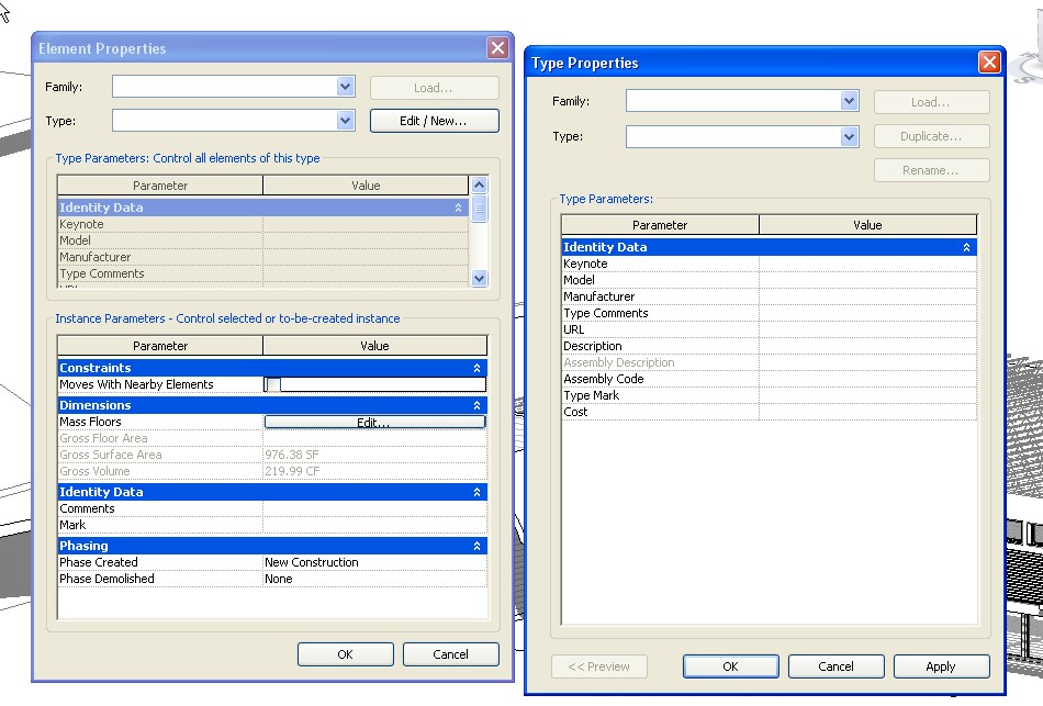

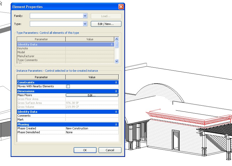

If I right click and go into element properties, I get this without the ability to change materials.

Go to the element properties and click on 'edit type'.

these are the options - I don't see 'edit type'

Wait - I get whqat you're saying - this is the dialogue that shows up...

OK, this confirms that it was created as a mass and not a hosted sweep.  Do it as a wall hosted sweep, or as an in-place family in the wall category.  You can change the appearance of the default mass material in the material settings, but I would not use a mass for this.
