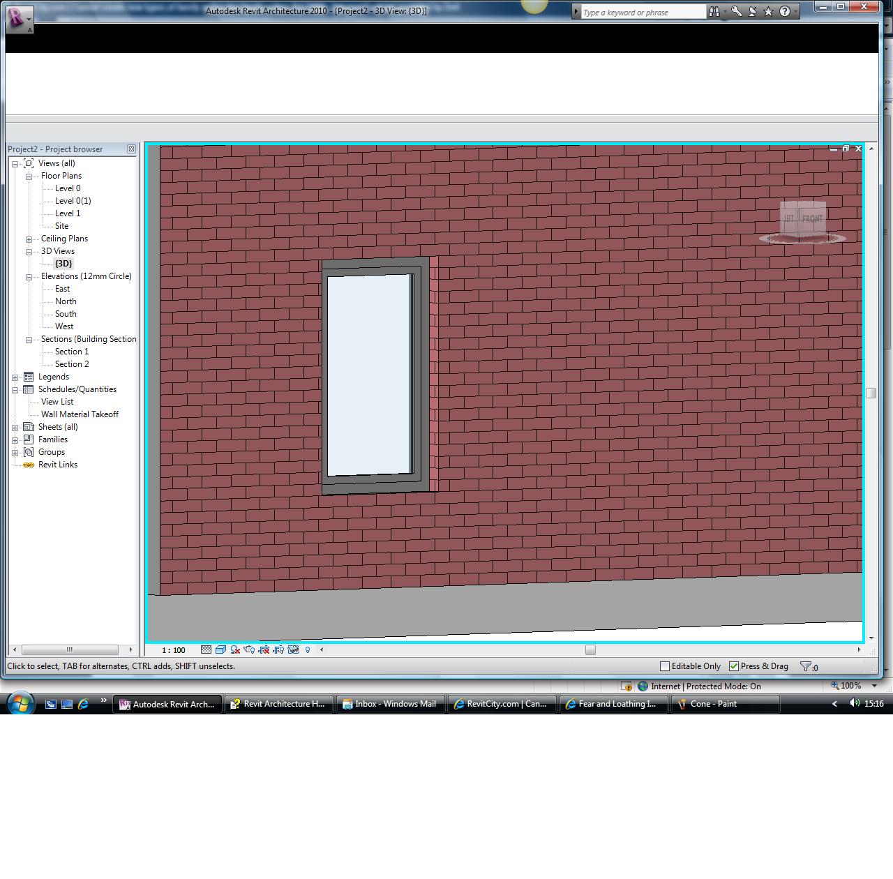

I have downloaded your file and don't see a problem with it, although I had to delete the assembly code before flexing it.  I loaded it into a project and there was no problem.
