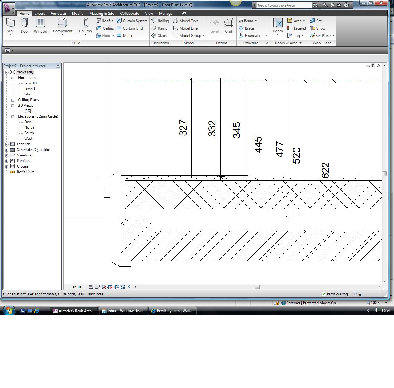

Mon, May 4, 2009 at 5:07:05 AM | Wall tile areas
tim123
Joined: Tue, Apr 12, 2005
1310 Posts
4 Stars: 19 Votes
I don't think that you can include worksets in view templates.  With respect to the dimensions, you should be able to dimension to any line - see image.  You may need to temporarily hide the joined wall to snap to the surface though.
Mon, May 4, 2009 at 6:29:43 AM | Wall tile areas
aspect
Joined: Tue, Sep 12, 2006
56 Posts
5 Stars: 2 Votes
Cheers Tim,
I thought I was going crazy given WWHub's comments, but glad to see that might not be true. You are right, if you temporarily hide the 1/4" wall, you can dimension to the stud wall.
