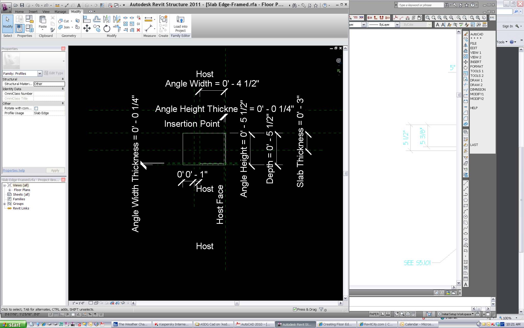

ok - so I tried this face base family - actually it is the slab edge modified.
1.  How can I have two cut patterns in one detail?  One for the concrete and one for the bent plate.

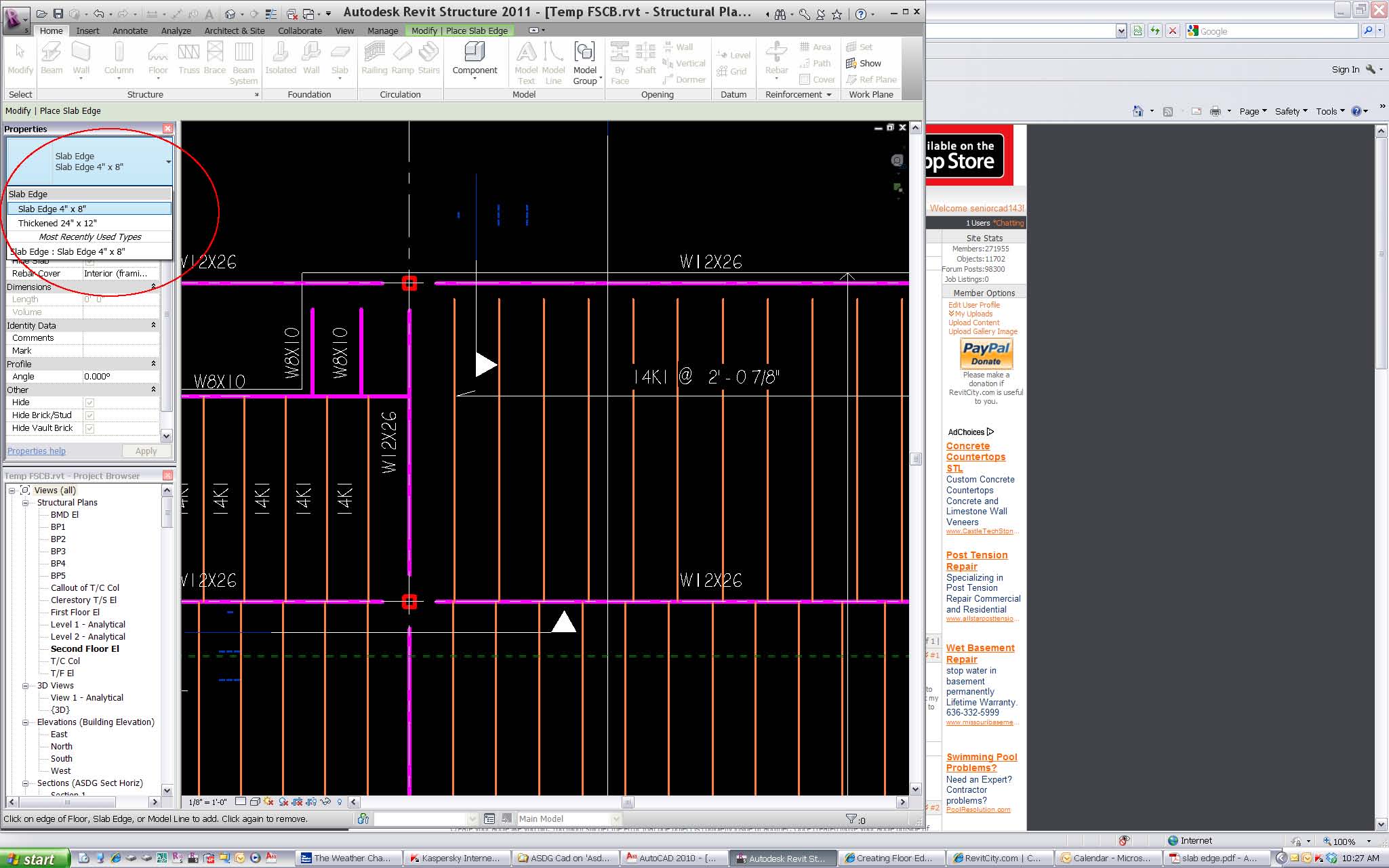

2.  I do not know how to pick it once I load it into my project - it is not showing up under the slab edge type in the properties box.  (image 2)
A image of the family is attached.  (image 1)

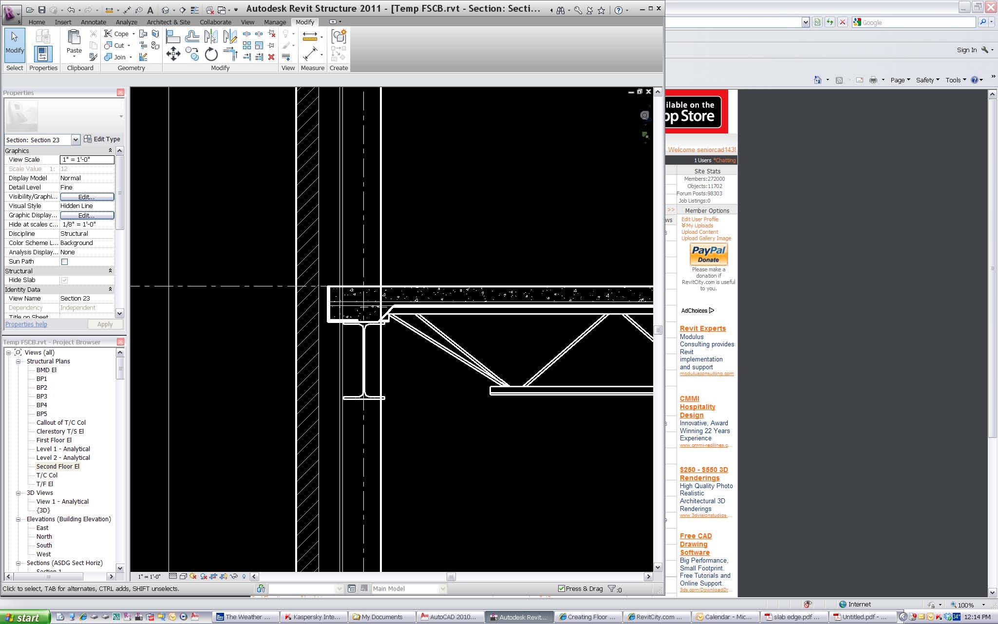

I tried the in place component (for my edge angle) with a thickened slab egde already placed.  (image below)
Questions:  I would like to change the OTB edge slab profile (I don't want the 45 degree slant) but I load it but it doesn't want to show up in the type editor.
I don't want the deck to show up going thru the thickend part.  Is there any way to sop it short?
