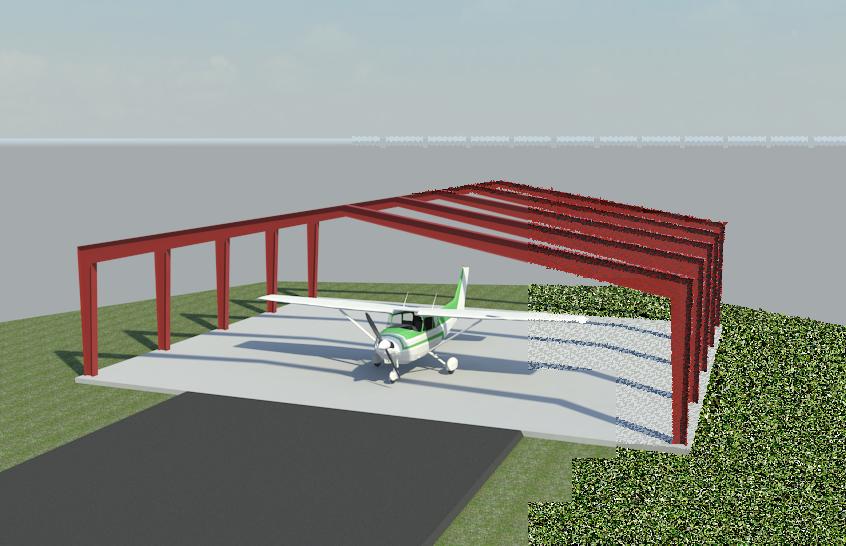

i don't get this- WHY do i see much SHARPER rendered
images in the gallery when i set mine to 10 for antialising?
you can't set it any higher than that..
i turned all the reflections off except for a 2 on the refraction
so i can see some glass..
and all the illuminations are on 8 and 5..
makes no sense to me..
i hope nobody is going to tell me to render for seven hours to a 600 DPI
printer setting and then somehow shrink it down to a JPEG to post..
what's going on here please..
