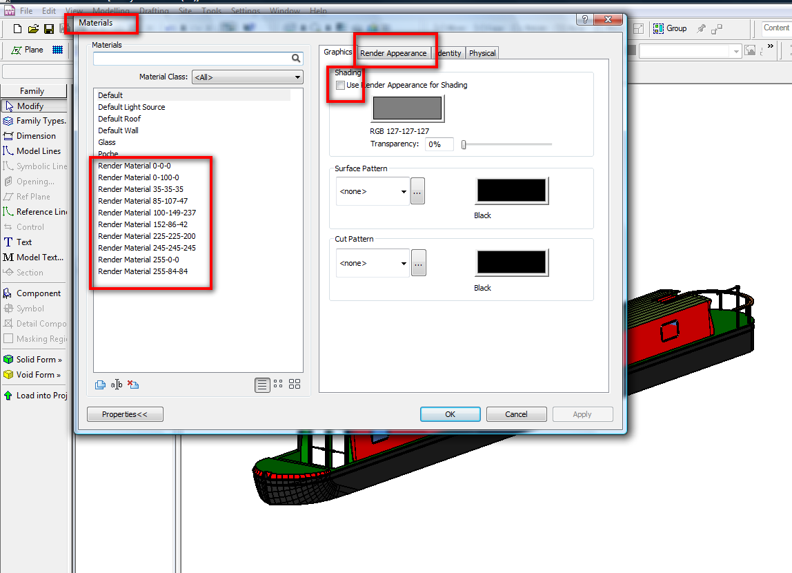

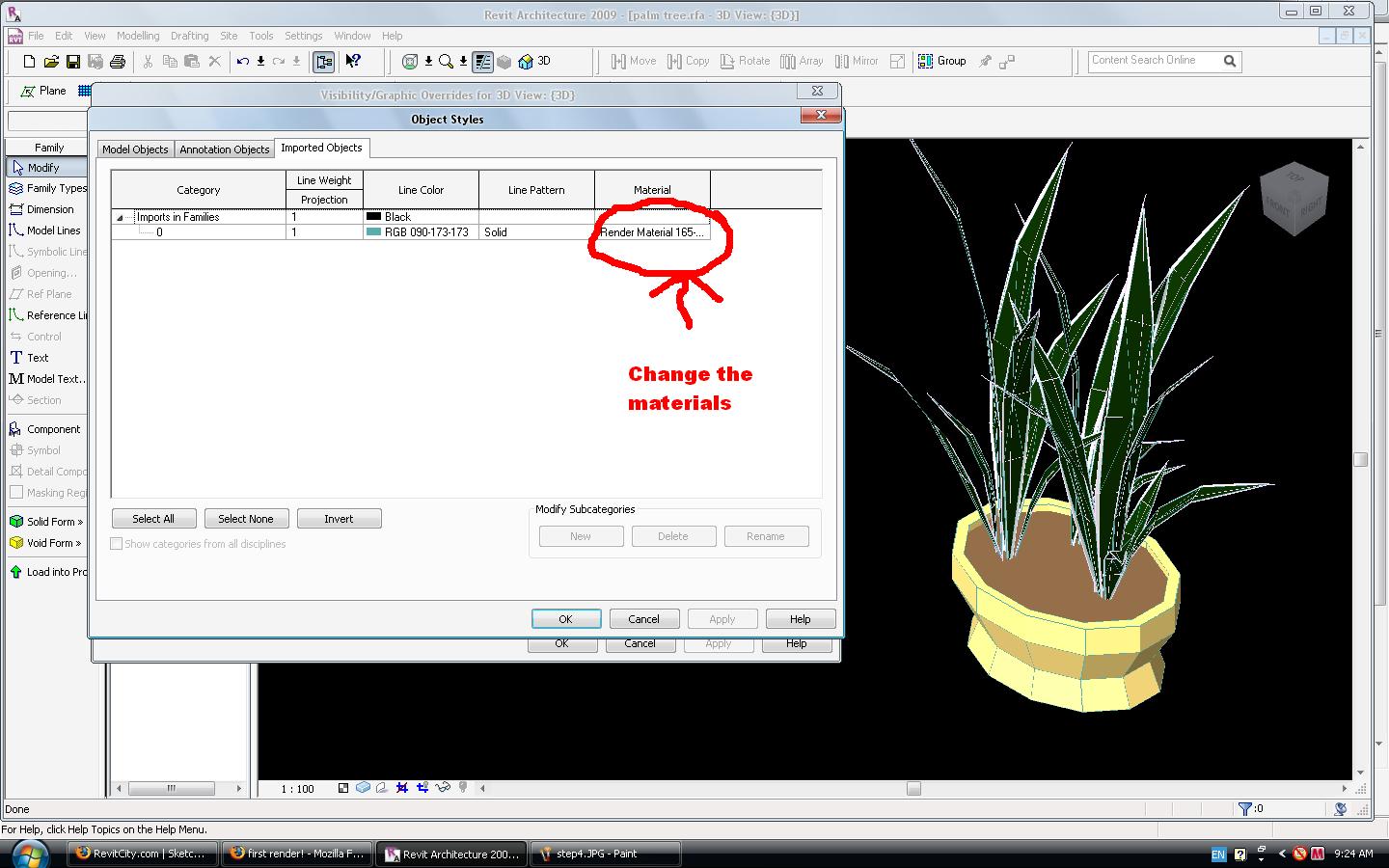

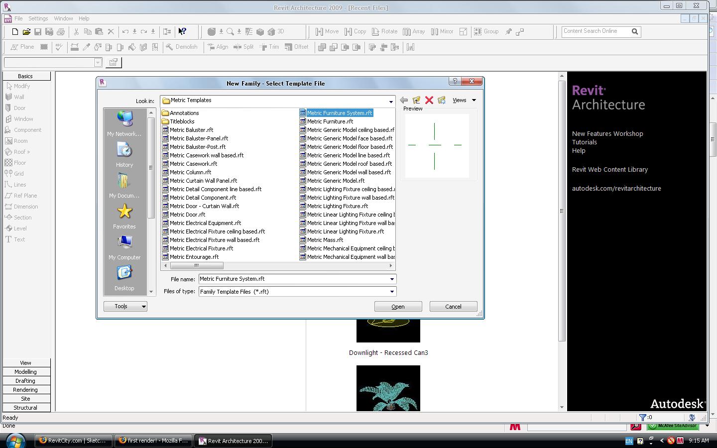

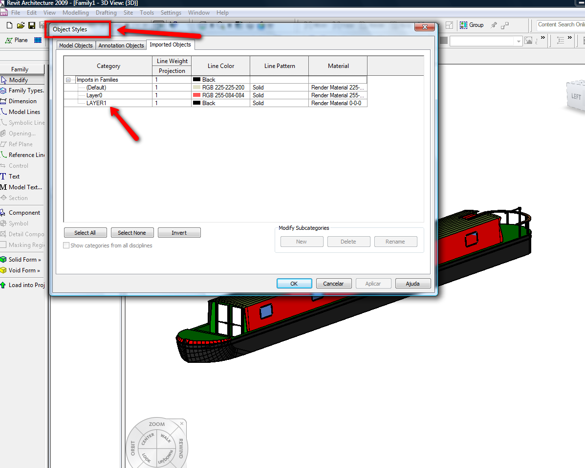

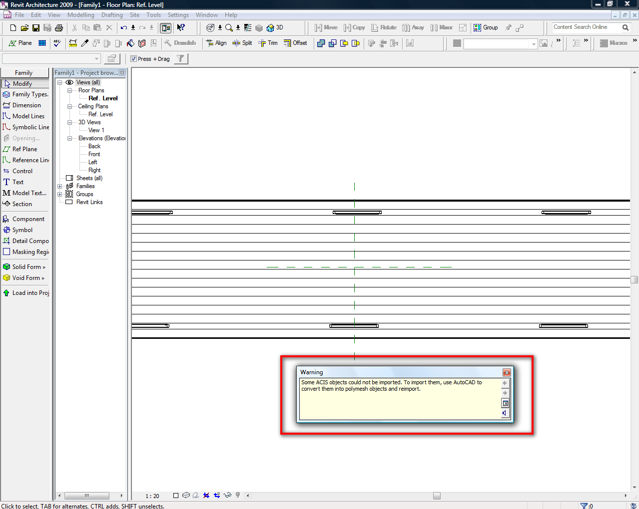

I did post several times this same issue, if you import directly to revit you gonna see that kind of advertising (like in the first image attached), so what i do is i go to autocad and change the obj, but if you don't want that you can create a "Metric/Imperial Entourage Family" then import the sketchup model and like you can see in the second image, if you go to the "Object Styles > Imported Objects" you only see the 3 layers with the respective "Render materials" but if you go to the "Settings>Materials" (like in the 3 image) you see the all colors the model are used, what you can do is change those "Render ###..." to the real name you want and change the "Render Appearence" with the material you want, save the model (family) and "load into Project"....

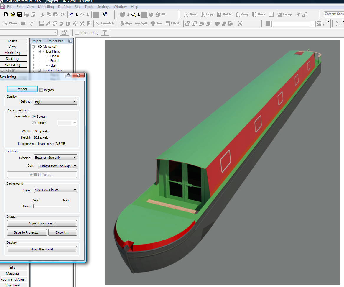

The final render... and the model you post....

After you "Load into project" go to the "Materials" and check if the "render...." have the materials you just apply in the family...

... ON THE OBJECT STYLES> IMPORTED OBJECTS> MATERIALS IT SEEMS THAT EACH LAYER HAS ALREADY A CORRESPONDNIG MATERIAL APPLIED WHICH IS THE MATERIAL FROM SKETCHUP. I CHANGED THIS MATERIALS AS TYPHOON SUGGESTED INORDER TO CHANGE THE MATERIAL APPLIED TO EACH LAYER WHEN RENDERED. LOAD THE FAMILY TO A PROJECT, RENDER, WHEN ITS DONE THE MATERIAL DONT SHOW UP. ANY INSIGHTS???

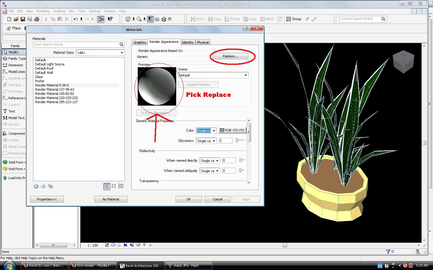

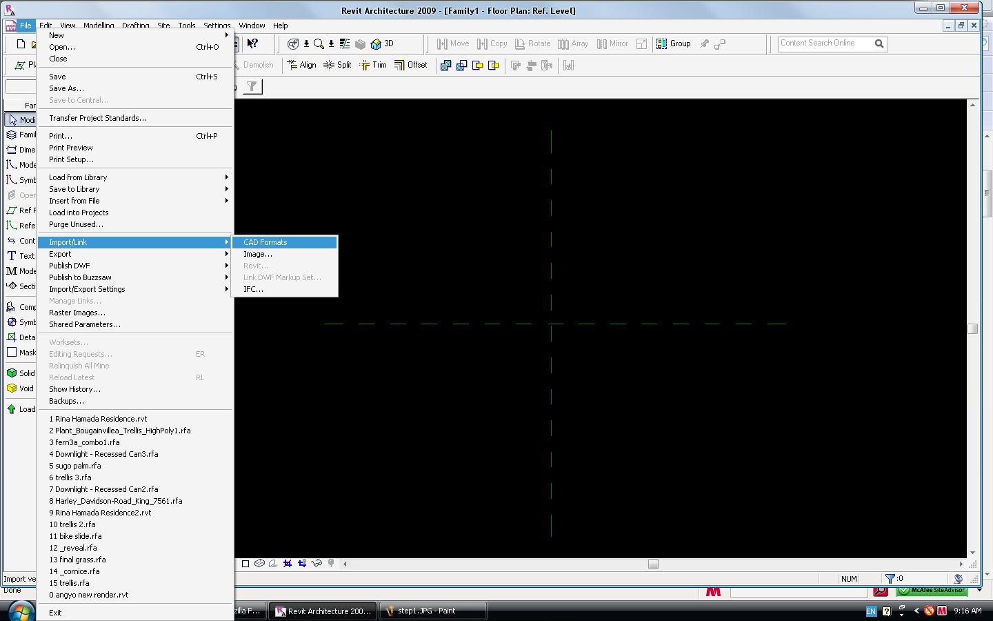

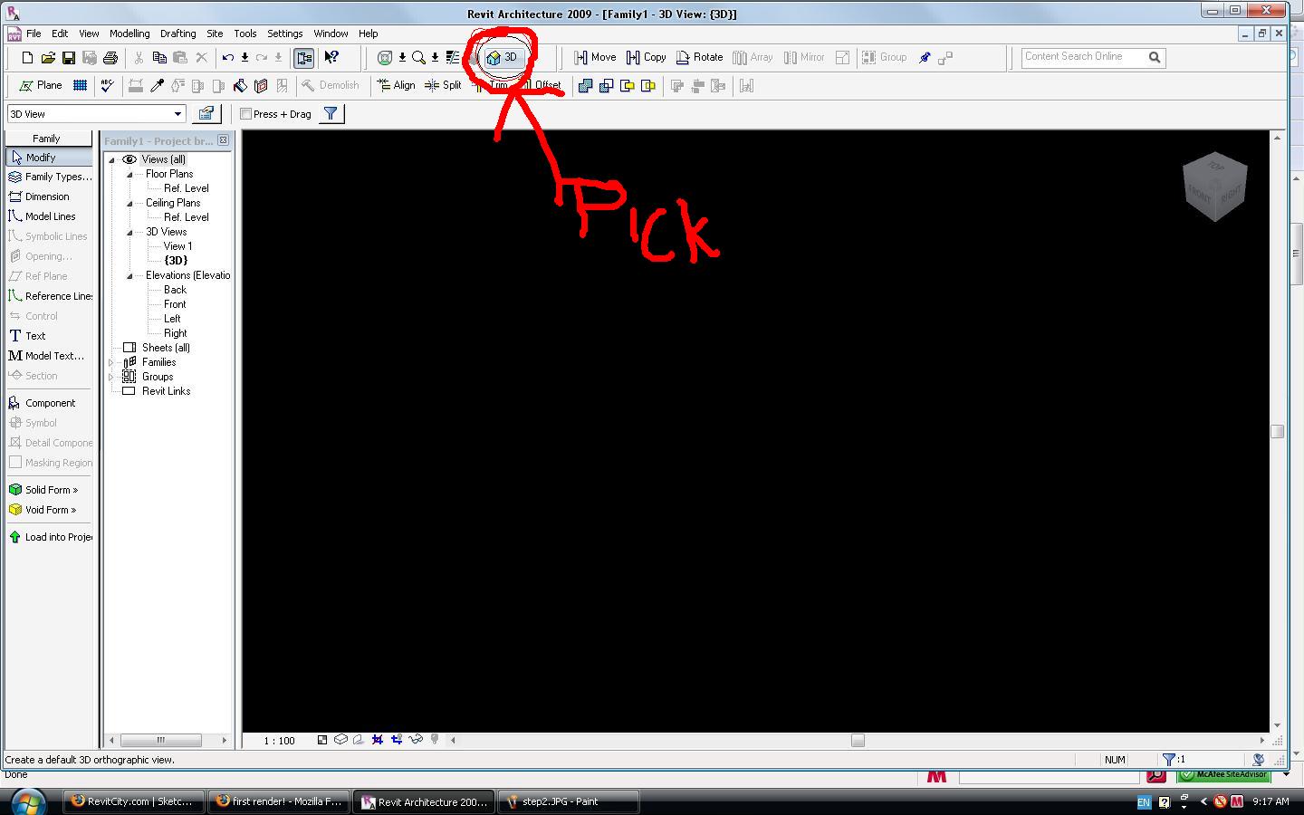

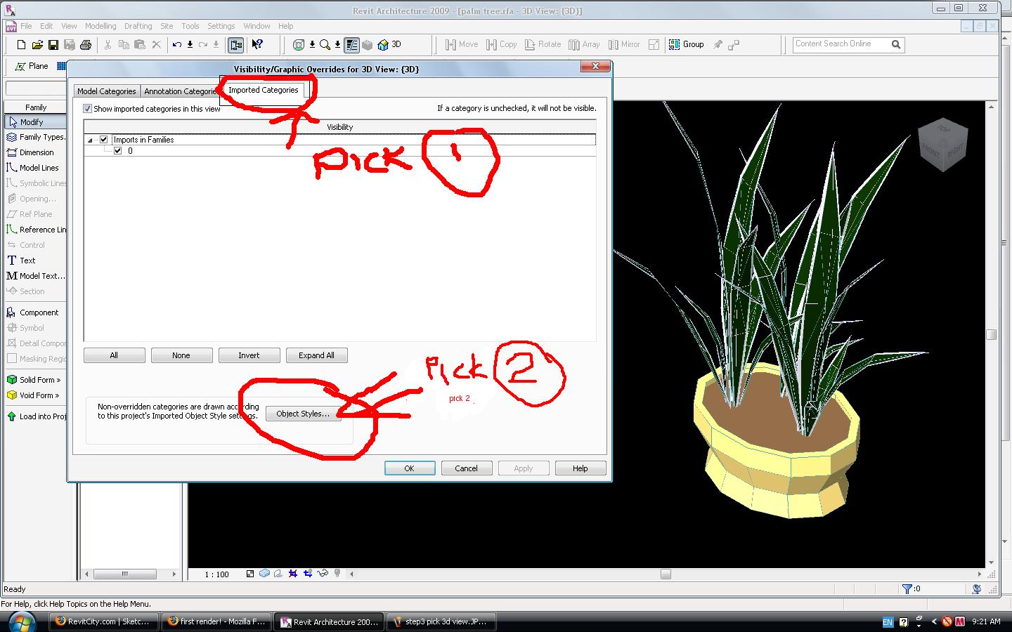

please look at the image...

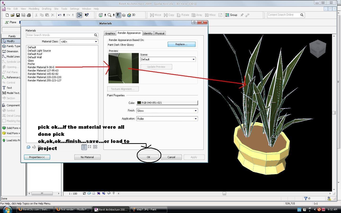

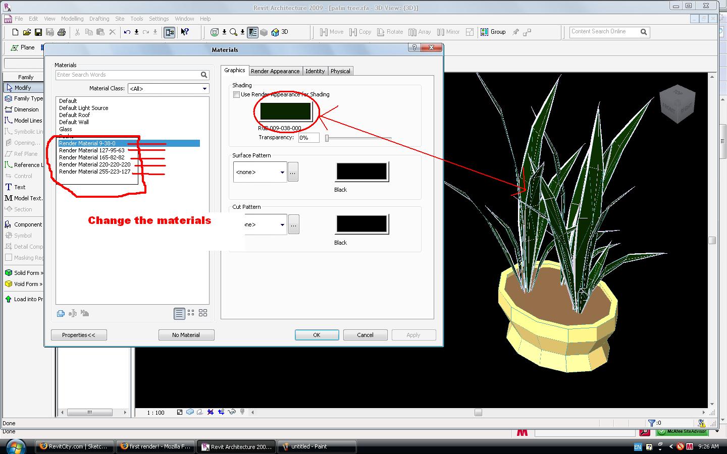

68059_step1.JPG68059_step2.JPG68059_step3_pick_3d_view.JPG68059_step4.JPG68059_step5.JPG

cont....

THANKS FOR RESPONDING TO MY REQUEST MARKIE. THAT'S EXACTLY WHAT I DID DURING THE COURSE OF MY EXPLORATION TO RESOLVE THE PROBLEM    MARKIE. I TRIED MODELLING SIMPLE BOXES LAST NYT IN SU,WENT THRU YOUR STEPS AND IT WORKED!! I TRIED THE "PLANT_SAGOPALM" DOWNLOADED FROM SU BUT UNFORTUNATELY THE MATERIALS/COLOR DOESNT CHANGE FOR ME AFTER I CHNGED THE MATERIAL CORRESPONDING TO THE LAYERS. BUT ANYWAY THANKS OR THE ENLIGHTENMENT MARKIE!! MAYBE I SHOULD TRY THE MODEL YOU USED ON YUOR SCREEN SHOTS.

I WENT THRU THE STEPS MARKIE SUGGESTED BUT STILL HAVING PROBLEM ON SU TO REVIT ISSUE. I WONDER WHY  SU MODEL I PERSONALLY CREATED, SAVED AS DWG AND IMPORTED TO REVIT ,CHANGED THE COLOR/MATERIAL OF THE MODEL WORKS FOR ME. BUT WITH MODELS DOWNLOADED ON SU WEBSITE IT DOESNT. I TRIED CHANGING THE COLOR OF EACH LAYER ON A MODEL BUT ONLY1  LAYER COLOR CHANGES AND MOST OF THE TIME ALL IS GRAY WHEN RENDERED. IM USING REVIT 2010 AND 2009 AND SU PRO 6. COULD IT BE A SOFTWARE MALFUNCTION, PC PROBLEM, VIRUS ON MY PC????

I dnt know...did you try my idea step by step?can u please send your file to my email,,and i will make it...if doesnt work maybe there is a problem with the object...but i think it doesnt have a problem...(markitek2007@yahoo.com)
