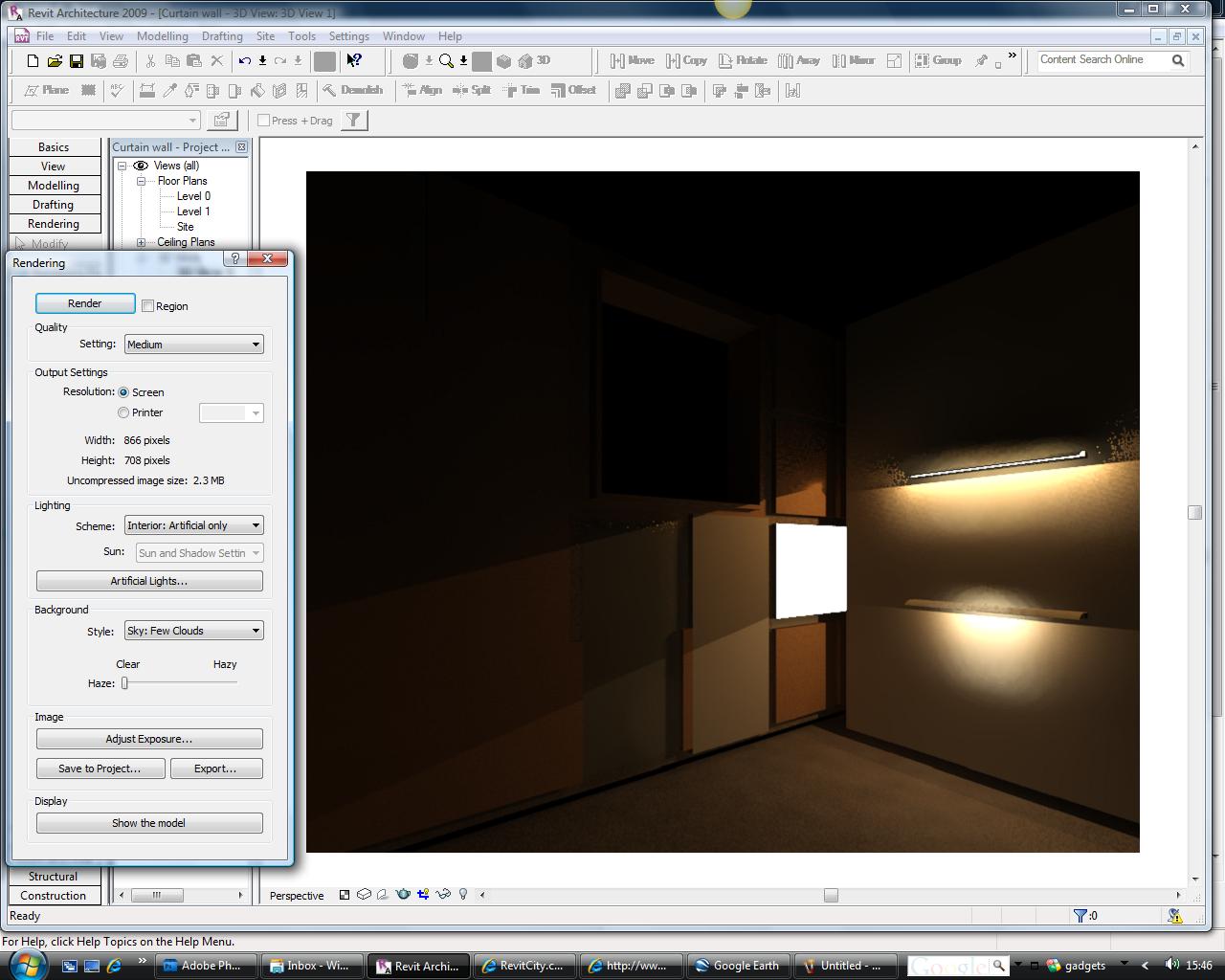

You can set the length that the light emits from - see image.

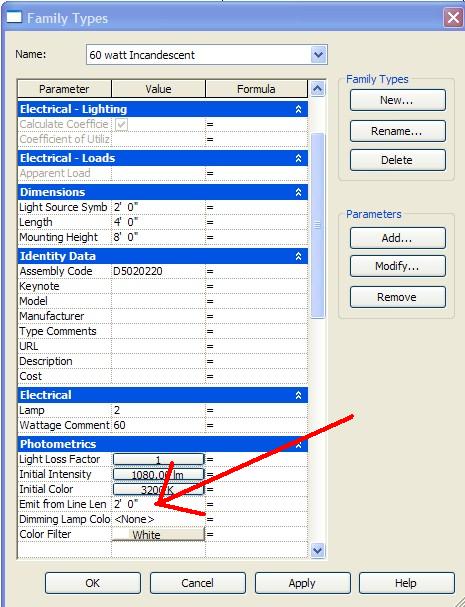

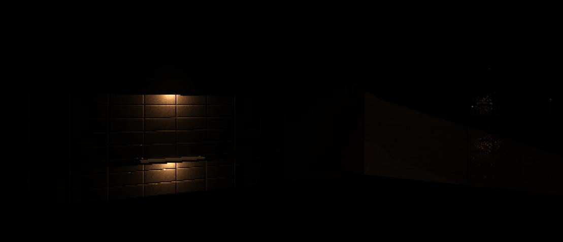

See attached.
The first is my properties screen shot.  The second is the light fixture rendered.  And the light fixture family is attached above.  The fixture is 4'-0" long and still shows up as a hotspot?

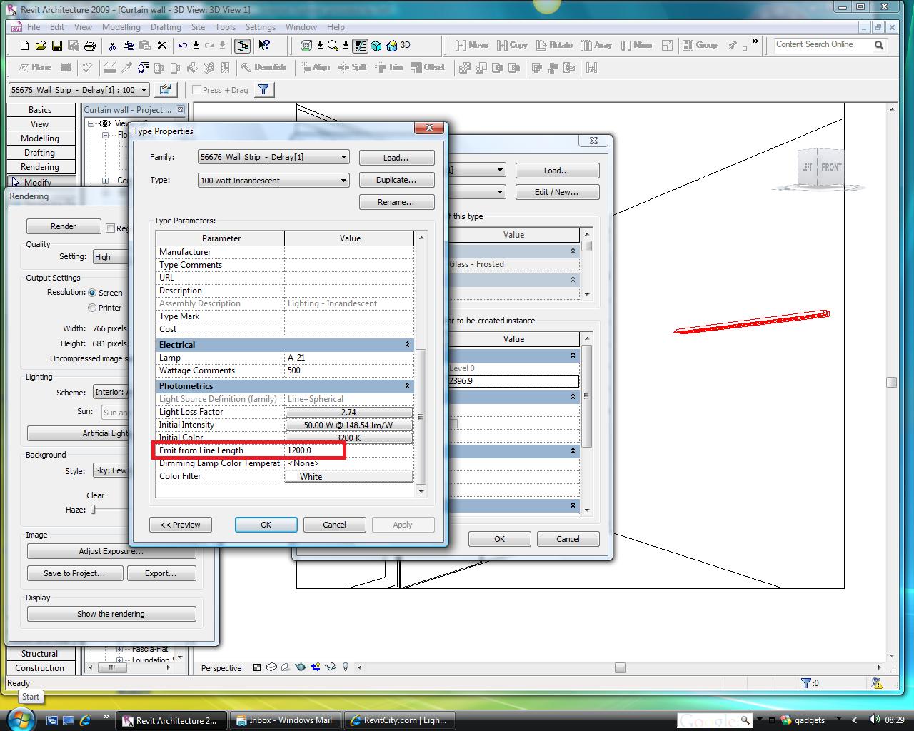

I'm not sure - are you sure it's the same light?  The top light in the image is your light with the 'emit from line length' set to 1200mm and the lower is 300mm.

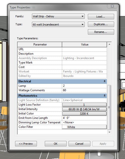

Here's my rendering, family used.
Also, take a look at the Revit file, that is attached to compare the properties with your file.

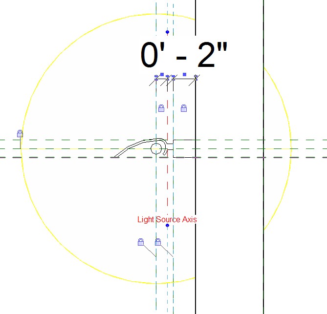

Fri, Apr 10, 2009 at 12:09:52 PM | Lighting fixture not showing ANY light
You have a 4' fixture but only a 2' light source.
In addition, your light source seems to be in the wrong place
Edited on: Fri, Apr 10, 2009 at 12:14:06 PM

Fri, Apr 10, 2009 at 12:16:25 PM | Lighting fixture not showing ANY light
Light source

WWHub,
Thanks for responding.  The Family 'Emit from line length' is 2'-0" in the family.  I still havne't changed that in the actual family.  But the top light 'Emit from line length' is set to 4'-0" in the rendering project (see picture I posted above).
As far as the light source axis in the family.  It may say the axis is in one place but the light source it self is located correctly.  I can change that axis, I was unaware that was mis-located.
