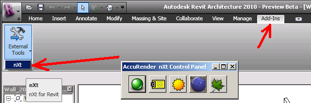

I've just installed the 30 day free trial but I can't for the life of me find tutorials or help. It is pretty straight forward, but it only works in the 3D view, not in camera view. When I create a camera view and go to Add-Ins (Revit Architecture 2010) and click on external tools, nxt is grayed out and I can't choose it. However it is available when I'm in the native 3D view. Is there something I'm doing wrong? I wanted to render a camera view.

I'm sorry that this has been a problem.
There is  video tutorial at:
http://www.renderplus.com/wk/AccuRender_nXt_Simple_Rendering_w.htm
There is a help system at:
http://www.renderplus.com/wk/Table_of_Contents_-_AccuRender_nXt_for_Revit_w.htm
See the Getting Started Section:
  • Open Revit and load a model. An additional menu item, Add-Ins should appear.
  • Make sure you are not in a Camera or Perspective View. (You can switch back after loading the add-in.)
  • Select Add-Ins, and the Add-Ins Ribbon should appear, with the External Tools button.
  • Select nXt From the External Tools drop-down list, and the Control Panel should appear.
