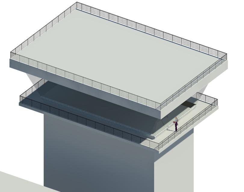

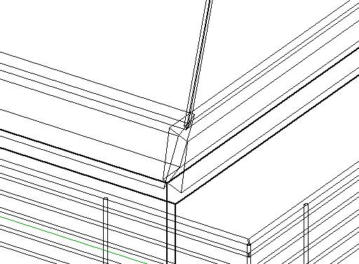

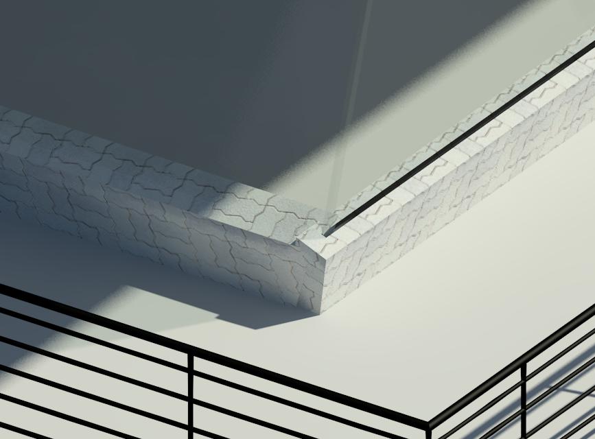

please see the images of this airport tower i'm trying to build..
where the glass angles and sits on an angled base and joins
at the corners and has been hours and hours of mish-mashing
generic model elements..
how would anyone even attempt something like these
kind of angles?

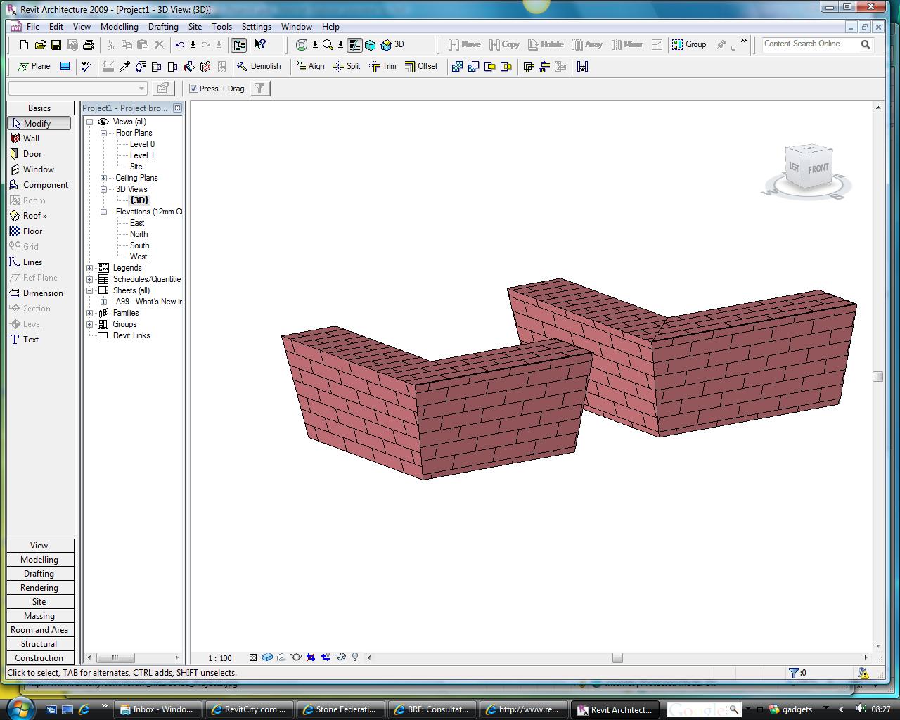

Create the walls as a blend - the illustration shows the first made as one blend and the second made as two blends - which gives greater control over the material orientation.  For the glazing, consider how this would actually be constructed.  You will have to have some kind of join here, even if its a gasket or silicone.  The galzing can be created in the same way as the walls - blends, or as sloped glazing.  Create new mullions for the gasket joins.

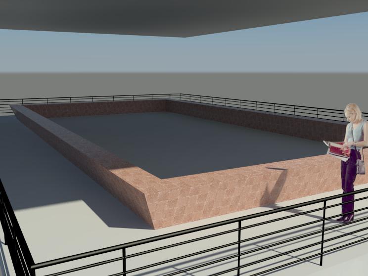

thanks so much for reminding me about the blend..
the joy that brings is unbelievable.. of course it helps
to be a little crazy like me..
see the image and all i did was create a big blend
with a big void in the center..
i have no idea how i would create a slanted curtain
wall in there though.. if you have any ideas on
that let me know.. but i'm so happy right now..
