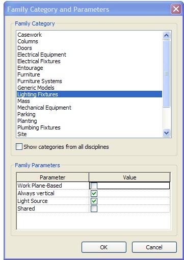

Open your light family and under settings / categories & parameters and uncheck the always vertical box.
Now reload the family - go to the appropriate view and rotate your light to vertical.

Thanks, but that is not an option for light fixtures.
In any case, I would like the light to hang down automatically, no matter the ceiling angle.  There is probably some data extraction and a formula involved here.
Tue, Apr 7, 2009 at 9:33:15 AM | Pendant light mounted to sloped ceiling
chuckbradley wrote "Thanks, but that is not an option for light fixtures."
LOOK AGAIN - You are absolutely wrong!

I appreciate your help, even though you are absolutely incorrect.  At least as far as what I'm looking at on my screen. Smile
Under Settings-Family Category and Parameters, there are only 3 parameters available for Light Fixtures. Light Source, Part Type and Shared.
MEP09 is the software version I'm using.
Thanks again.
Tue, Apr 7, 2009 at 1:19:46 PM | Pendant light mounted to sloped ceiling
Thread Post Kudo! #6
Well, maybe something different in MEP - here is Architecture 2009.
This is just a lighting fixture - ceiling based has the same GUI.

The difference is yours is a Ceiling Based light fixture.
We are using linked architectural models, so everything has to be "face based" or it will not place on the surface.
Thanks again!
Tue, Apr 7, 2009 at 2:07:45 PM | Pendant light mounted to sloped ceiling
NO - as I said, this is just a light fixture ......  ceiling based has the same GUI.
BUT NOW WE KNOW THE REST OF THE STORY!  You used a generic model (face based) template - not  a lighting template.  If you had given that information eariler, we could have saved a lot of time.
Faced based generics may work best for what you are doing but you could have used just a light fixture and aligned it to surfaces.

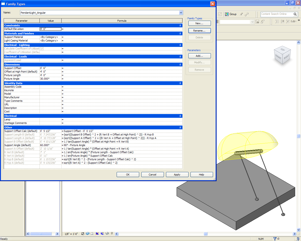

This is the only other way to do it....
It took me about a day to get this working, but I would be happy to sell it to you Smile
Nick

Get a family started, use the screen shot and formulas and see where that takes you. I would be happy to help trouble shoot or work on a family. Or sell it if you want it done for you. Smile
Nick

NKramer - Can I get your sloped ceiling family? I typed in everything from your attacment and it doesnt work for me. Please help.
